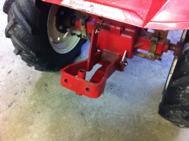

C-101plowerpower 1,606 #2 Posted October 25, 2015 probably be better to pack some weight up front, i've got a 8" plow and my horse get a tad light in the front(especially when picking the plow back out of the ground) also i would fabrecoble a clevis hitch for the plow as it gives a few more settings 1 Share this post Link to post Share on other sites
squonk 45,592 #3 Posted October 25, 2015 If you were to buy a WH clevis hitch and can get the slot hitch pin to come out of the trans, just replace the hitch. Also weigh up the wheels front and rear. This is the hitch on my 1267 1 Share this post Link to post Share on other sites

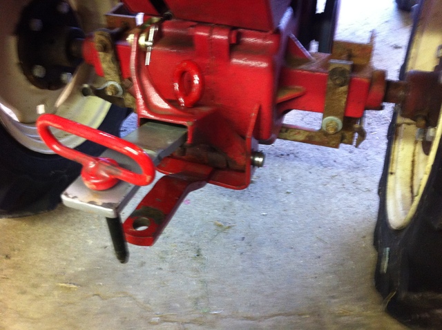

CasualObserver 3,414 #6 Posted October 26, 2015 Don't modify anything.... all you need is the adapter. @wheelhorseman1000 is making repops of the Brinly HH-180 factory part which is out of production. http://www.wheelhorseforum.com/topic/53370-wheel-horse-brinly-slot-hitch/Here's the link to the original literature sheet I got with my NOS hitch which shows you the correct installation. (most people naturally use it upside down and don't know it)http://www.wheelhorseforum.com/files/file/983-hitch-rear-slot-to-sleeve-hitch-adapter-brinly-1966-hh-180/ 1 Share this post Link to post Share on other sites

squonk 45,592 #8 Posted October 27, 2015 (edited) The adapter is nice but, due to the length of it a 10" or 12" plow is quite the bear to get back out of the ground with a manual lift. I have one just like it but shortened it up. Made it a lot easier until I got the clevis hitch. The plow is also easier to control side to side movement being shorter. Edited October 27, 2015 by squonk Share this post Link to post Share on other sites
briankd 833 #9 Posted October 28, 2015 Don't modify anything.... all you need is the adapter. @wheelhorseman1000 is making repops of the Brinly HH-180 factory part which is out of production. http://www.wheelhorseforum.com/topic/53370-wheel-horse-brinly-slot-hitch/Here's the link to the original literature sheet I got with my NOS hitch which shows you the correct installation. (most people naturally use it upside down and don't know it)http://www.wheelhorseforum.com/files/file/983-hitch-rear-slot-to-sleeve-hitch-adapter-brinly-1966-hh-180/ this here is what I was thinking about I can fabricate this myself very easily was at the tri state swap meat in Portland indiana and couple guys had had a couple brinly plws. they hacked off the sleeve hitch and welded up a flat tounge that would slide into factory wheel horse receiver hitch Share this post Link to post Share on other sites
briankd 833 #10 Posted October 28, 2015 the top one there looks way too long make it as short as possible it would be ok Share this post Link to post Share on other sites
