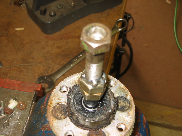

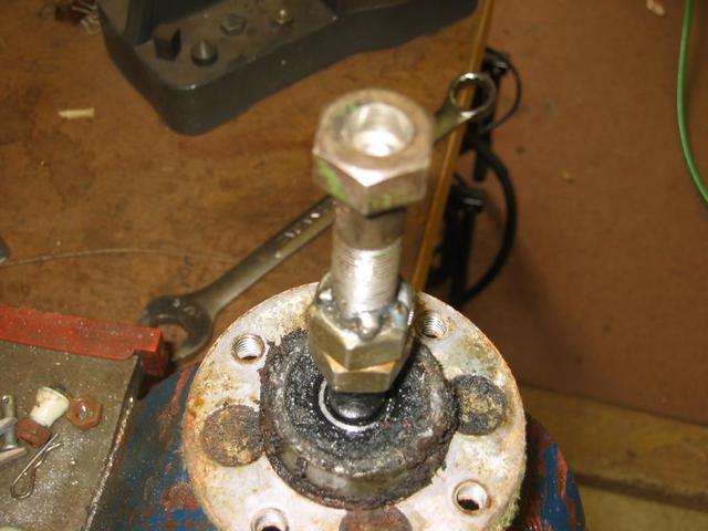

pfrederi 19,465 #6 Posted October 25, 2015 (edited) I guess I can finally claim victory but not without a casualty. This was right up there with pulling a D series hub. No fun at all.A few more days of soaking and I re-attacked to day. Hammering on the shaft end even with the nut on was damaging threads so i dug out some full thickness GR8 nuts. Still no movement. Came up with a device that let me use the air chisel. That heat and a cheater bar on the pipe wrench and I got the pulleys off. The bottom of one housing broke were the snap ring is located. The second one would barely turn chattering all the time and I could only move it with the 3 foot cheater pipe on the pipe wrench . Used the air chisel and she finally loosened up.Welded a nut on end of 5/8 NF bolt (threaded about half way). Drilled the center of the bolt head so the air chisel wouldn't skitter off. Put a nut on the shaft and ran it all the way on. Threaded on my device then brought the first nut back up until it jammed on the device. This maximized the threads to take the pounding of the air chisel. Didn't think to take picture till i was done. Edited October 25, 2015 by pfrederi Share this post Link to post Share on other sites
