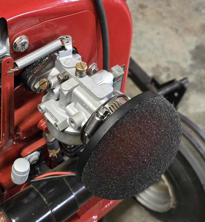

kpinnc 18,967 #51 Posted October 17, 2025 On 1/5/2016 at 1:10 PM, RedRanger said: With the 8HP filter element installed, I cannot get the hood on. Sometimes you can find the occasional K141/ 161 air cleaner. They are very much like the K90/ 91 in size. I've also used a MX filter but I had to make an adapter for it. This machine will never be a mower again so this worked very well adding a K181 on a Lawn Ranger. 2 Share this post Link to post Share on other sites
