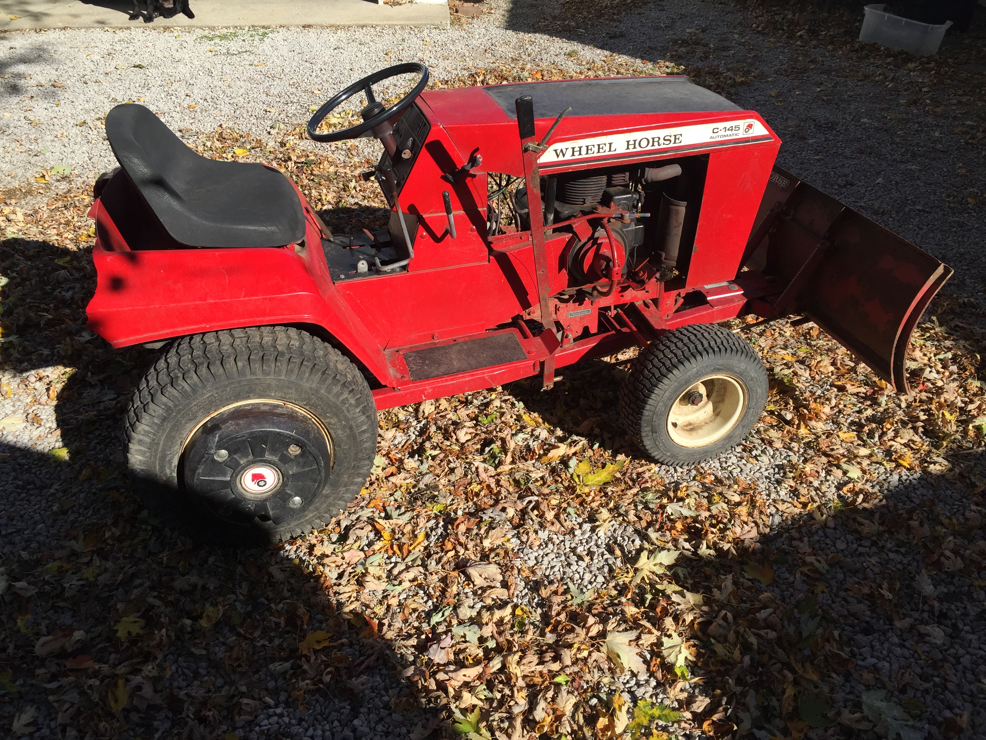

Dkphillips 22 #8 Posted October 27, 2015 Hopefully there are photos of my new acquisition (C145) in this post. I have been having lots of trouble getting photos to post. As you can see I am in need of a new fender section and have been discussing this problem with another member. 3 Share this post Link to post Share on other sites
Sparky-(Admin) 24,646 #9 Posted October 27, 2015 Which hydro does it have? The first half of 1980 the C-145 came with the Sundstrand hydro....then mid-way thru 1980 they switched over to the Eaton 1100. If you don't know take a look at the hydro filter, if it points to the side its the Sundstrand, if it points towards the rear of the machine its the Eaton 1100. I don't know what you paid but it looks to be in very good shape!Mike......... Share this post Link to post Share on other sites
Dkphillips 22 #10 Posted October 27, 2015 The filter points to the rear. And I just purchased a new filter today and plan to change the hydro oil tomorrow. Hopefully I got a correct filter. Do you happen to know the Fram filter number.? I paid an outrageous amount for the tractor with blade, weights and chains...$250!!!!!! I bought it as soon as I saw it on Craigslist. The seller said he had very many inquiries but I was first so I lucked out. I had a C145 for over 25 years and just had to have this one. Sent from my iPhone using Tapatalk 1 Share this post Link to post Share on other sites

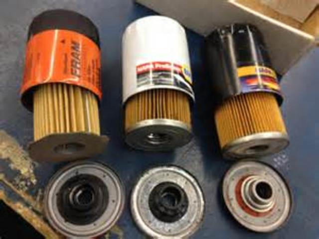

squonk 45,575 #17 Posted October 27, 2015 I posted a pic of the Fram cut open next to a Napa filter. Now it's gone? Share this post Link to post Share on other sites
WHX?? 55,148 #19 Posted October 27, 2015 I'm lost here Mike ...what is junk about them? Looks like they arn't quite as pleated as the others so??? I was always a fram guy but just because they seemed to always have the fitment and the selection...at least at my farm & barns stores.... Share this post Link to post Share on other sites
bmsgaffer 2,069 #20 Posted October 27, 2015 More pleats = more surface area = better flow and more filtration.You can tell how few the fram has compared to the other two. A buddy of mine has had 2 fram filters disintegrate and get in his (car) engine, first one he thought was a fluke, second one toasted his engine. 1 Share this post Link to post Share on other sites
squonk 45,575 #21 Posted October 27, 2015 Look at the end caps on the Fram. They are cardboard! Share this post Link to post Share on other sites
