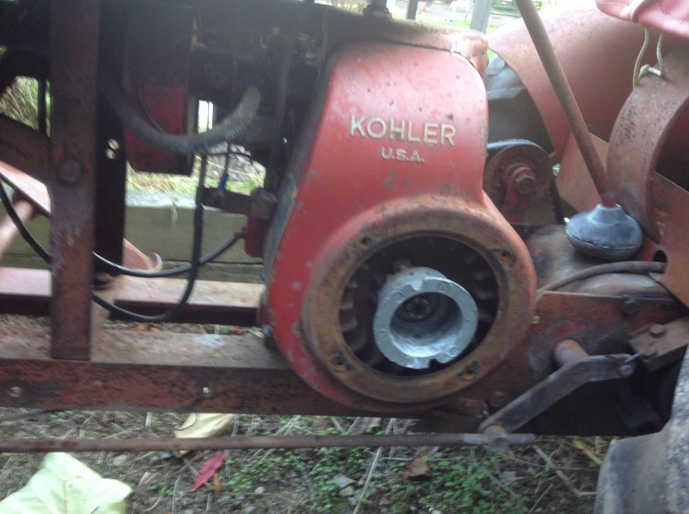

Springer 1 #1 Posted October 18, 2015 (edited) can not find a pull start for my K91 kolher so was hoping there is a small engine that will fit under the hood without having to cut it to get a different engine in. The engine I have now just needs a pull start to run but hard to find. Any help much appreciated . Edited October 18, 2015 by Springer Share this post Link to post Share on other sites

squonk 45,313 #3 Posted October 18, 2015 A Tecky recoil should work. 2 Share this post Link to post Share on other sites
Springer 1 #4 Posted October 23, 2015 A Tecky recoil should work. A Tecky recoil should work. Share this post Link to post Share on other sites
Jake Kuhn 1,598 #5 Posted October 23, 2015 yep the tecumseh recoils work just fine and are easy to find just have to make sure you get the right length cup. And if you have no luck you can always stick to just a rope....a lot cheaper than a recoil just not always the most fun to use. Share this post Link to post Share on other sites
woodchuckfarmer 333 #6 Posted October 23, 2015 A rope is not bad if they start first pull. Share this post Link to post Share on other sites

sorekiwi 761 #8 Posted October 25, 2015 The RJ I had many years ago had a Tecumseh recoil starter on it. Worked just fine. Share this post Link to post Share on other sites
