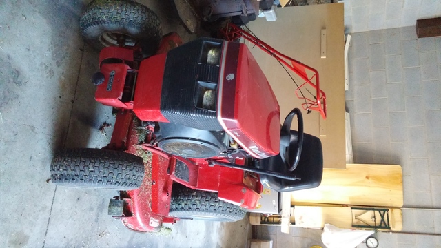

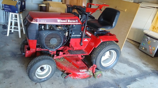

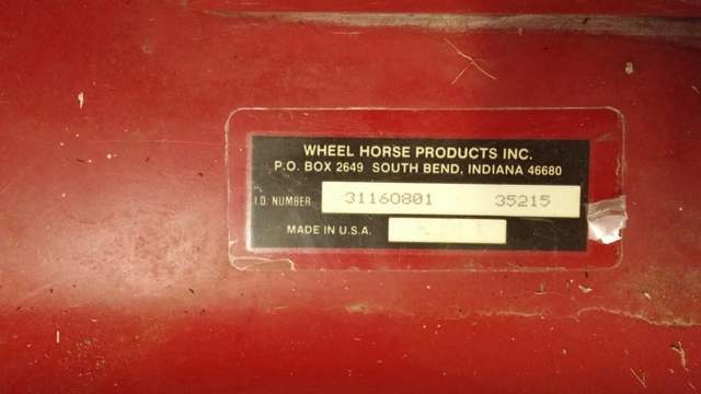

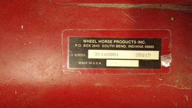

chrisagore 7 #1 Posted October 14, 2015 Hello,I just bought my first Wheel Horse this past weekend. My brother-in-law new i needed a mower and found it through a friend. He educated me a little on Wheel Horses and told me this was a good buy. I paid 500 for the tractor and it also came with a trailer and a bagging system. I've got to go back and get the bagger this weekend. I'm starting to research my Horse to find out all i can. I know this is the '89 model. I'm looking for advice on maintaining and a little restoration. This thing has been sitting in a garage for two years. It started right up and ran for a while, but then shut off. I drained the gas and i'm gonna replace the fuel filter. It ran great before it shut off, no smoke, no noises, blades engaged and ran fine. I'm excited about this tractor and i'm looking forward to learning all i can about it. 5 Share this post Link to post Share on other sites
muz123 1,193 #2 Posted October 14, 2015 (edited) Welcome and Very nice wheel horse!! I love the sound of the Onan engines!Now all you need is a blower or a plow and you will be ready to go for winter!! Also it was a good buy!! Dave.. Edited October 14, 2015 by muz123 Share this post Link to post Share on other sites

CasualObserver 3,414 #4 Posted October 14, 2015 indeed. I'll second that looks like a nice tractor for the price. A very capable machine. Share this post Link to post Share on other sites
RedRanger 1,470 #5 Posted October 14, 2015 Looks to be in great condition. Welcome to RS! Share this post Link to post Share on other sites

953 nut 64,152 #10 Posted October 14, 2015 Your brother in law was right, that was a great buy. While you are working on the fuel system I would advise replacing the rubber fuel line. The ethanol gas you get today will ruin the rubber. You should run non ethanol gas in any lawn equipment, go to buyrealgas.com, put in your zip code and it will tell you where to find it. I have found that adding a little "Seafoam" to the gas is a goo thing too.Here is a copy of the operators manual. http://www.wheelhorseforum.com/files/file/4367-tractor-1989-400-series-8-speed-om-wiringpdf/ 2 Share this post Link to post Share on other sites

doc724 925 #12 Posted October 14, 2015 Drain the tank and clean it and install a new fuel line shut off valve (and bushing) in the tank. This is in addition to changing the fuel line and Seafoam use as Richard suggested. Make sure the engine fins are not clogged and the engine breather may need cleaning as well.Check the condition of the two 9 pin connectors (one goes to the engine, the other is up high behind the battery). They are prone to developing open circuits due to resistive (I^2R) heating at the connections. You can get replacements from Bob Maynard here on RS. Also, check the fuse holder, another location for open circuits also due to I^2R heating and well as proximity to the rear cylinder. All of these open circuits are the result of corrosion on the copper alloys. The WH engineers could have used tin plated wire and terminals on all electrical connections, but for some strange reason they did not. Enjoy your Onan. I like mine, but I also like the simplicity of Kohlers 4 Share this post Link to post Share on other sites
