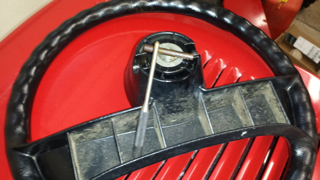

JERSEYHAWG / Glenn 4,527 #2 Posted October 10, 2015 Hi Don, when I installed Matts pedai kit on my 520, the next thing to go was the column shift. Just garbage and in the way. I cant remember exactly, but the first step was to soak the steering wheel roll pin and get that out of the way. That was really the main hurdle. I will have to look back and see if I documented with pictures. As a note on that pedal kir. I myself loved it, that colum shift was something in the dark ages, anyway, getting that wheel off is your first step. Will be following along. Good luck.glenn What I found doc. Not much to it at all easy peasy. 1 Share this post Link to post Share on other sites

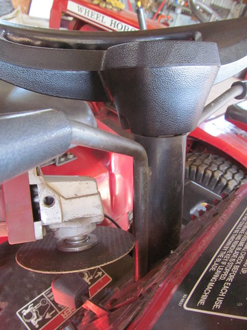

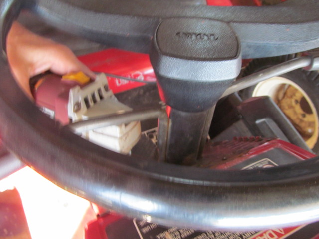

Ed Kennell 44,971 #3 Posted October 10, 2015 Plan B ....if you can't get the wheel off. 4 Share this post Link to post Share on other sites
squonk 45,580 #4 Posted October 10, 2015 Yes. A torch can be messy! 2 Share this post Link to post Share on other sites
AMC RULES 37,254 #5 Posted October 10, 2015 One of these should do the trick. 2 Share this post Link to post Share on other sites

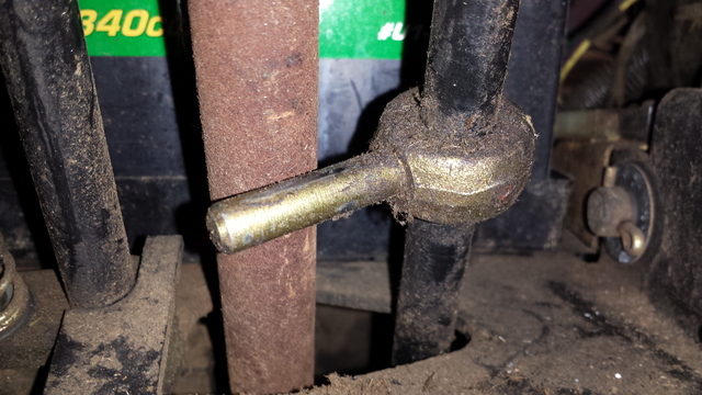

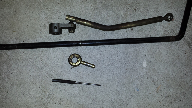

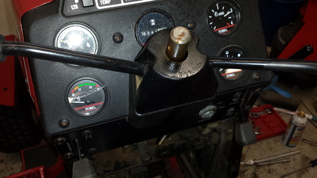

doc724 925 #9 Posted October 11, 2015 UPDATE: Here is how you do it, without resorting to plan BRemove the steering wheel, washers and dust cover that goes around the steering shaft.Remove the tower plate that holds the gaugesRemove the battery (so you can gain access)Unbolt the throttle lever asm from the upper tower (the upper tower is the part that the hood latches to when in the closed position)Disconnect any electrical connectors if there are lights or buttons on the upper towerDisconnect the hydro lift lever from the valve lever (one nut) and remove the small bracket which holds the lift lever in positionLift the upper tower off the tractor. The hydro control lever and the lift lever with a little jockeying will lift right out. You may have to temporarily lift out the steering shaft, but it will drop right back into place.Take the tower asm with the lift levers still in it to your work area. Position the hydro control lever on a vise and use knockout punches to drive out the spiriol pins which hold the two cams to the shaft. Then just lift out the hydro control lever.Reverse the process for reassembly.Total time for the repair is 90 minutes or less and most of that time is spent getting the steering wheel off.Of course, Plan B is quicker!Thx to all who responded 1 Share this post Link to post Share on other sites
