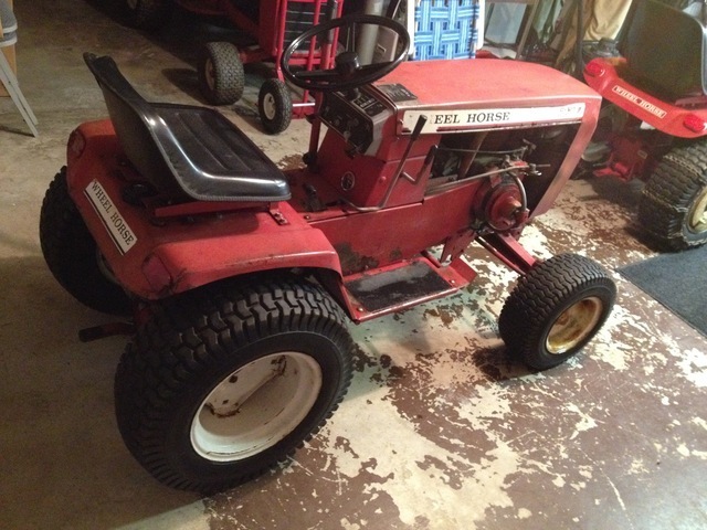

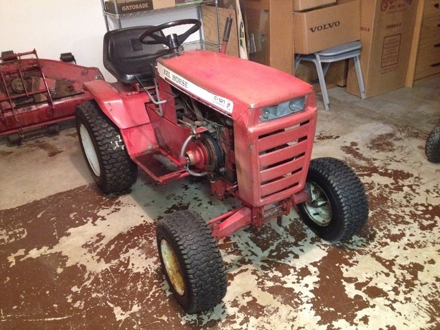

Zeek 2,299 #26 Posted December 29, 2015 That stinks about the engine . . . the rest of that tractor is in very respectable shape! The grill alone is usually bashed out of shape from hitting trees or small children , but that thing looks very straight and very little rust 3 Share this post Link to post Share on other sites

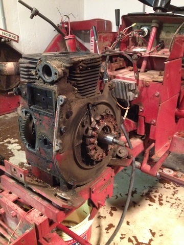

TDF5G 2,074 #31 Posted February 23, 2016 (edited) Here's a video I took after pulling the head. The link is between the first 2 pics below. Don't know how it ended up there, I thought I posted it first. And a few photos I've taken for reference of tearing it apart. It's been a slow project so far. Not had much time to work on it. The pulley and the flywheel pulled off with no problem. Next step is to get the block off the frame and on the workbench. Just gotta clean off the workbench first! IMG_2780.MOV Edited February 23, 2016 by TDF5G 2 Share this post Link to post Share on other sites
Tankman 3,528 #32 Posted February 23, 2016 Great find and nice Stallion! Hope the engine rebuild goes well for you. Share this post Link to post Share on other sites
Ed Kennell 46,441 #33 Posted February 23, 2016 Good luck getting those 4 bolts out of the rocker plate. I never did get mine out of my C-101 when I did the redo. 1 Share this post Link to post Share on other sites
semperfi8185 56 #34 Posted February 23, 2016 The good news is that it is a cast iron engine. Should be able to rebuild it. 1 Share this post Link to post Share on other sites

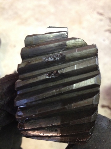

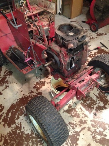

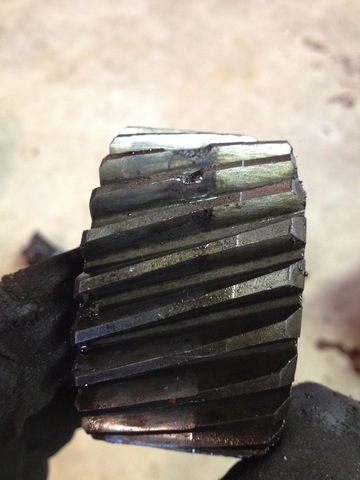

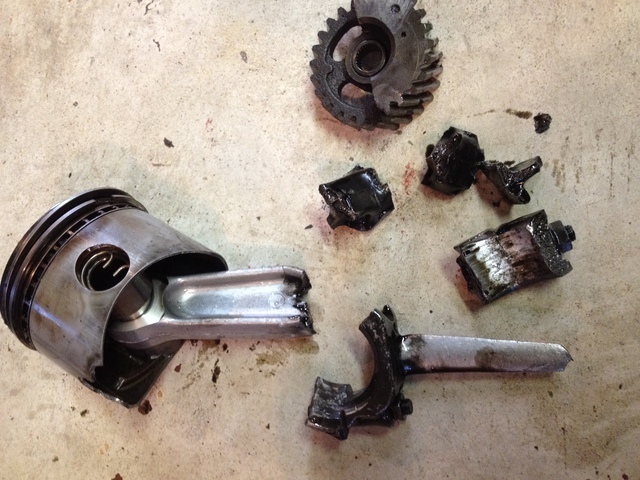

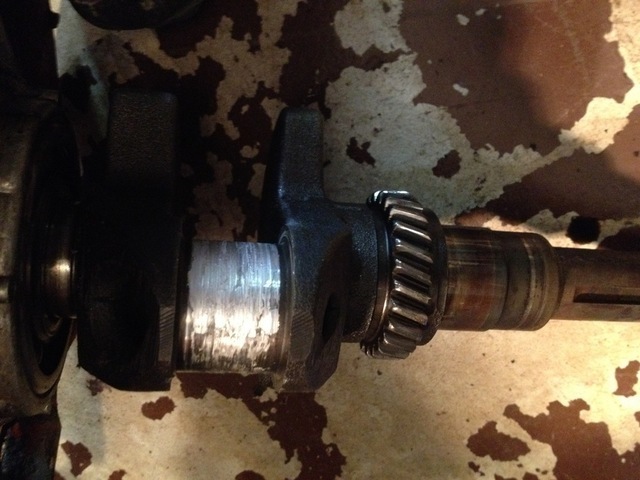

TDF5G 2,074 #35 Posted April 4, 2016 (edited) I haven't had much time to work on it. On Saturday I pulled the engine out of the tractor and removed the pan. I know we like pics so here's the damage! The bore doesn't look bad but may be out of round. Notice damage to piston skirt also. Cam appears ok. One gear damaged. Edited April 4, 2016 by TDF5G 3 Share this post Link to post Share on other sites
MWR 321 #36 Posted April 4, 2016 Just a small application of JB Weld should fix all that. 2 Share this post Link to post Share on other sites
ericj 1,580 #37 Posted April 4, 2016 if that's a balance gear, take it and the rest f the balance gears and throw it on the scrap pile. all of the kohler singles I've rebuilt, or should I say had rebuilt, i've left the balance gears out and I don't really notice any difference. A lot of times you can have the crank shaft polished to get the build up of aluminum of with out turning the crank, as long as it's not out of round. good luck on the rebuild. eric j 2 Share this post Link to post Share on other sites
953 nut 67,160 #38 Posted April 4, 2016 Some muriatic acid will remove the aluminum deposits without damaging the crank, then you can see if there is any real damage. 2 Share this post Link to post Share on other sites
