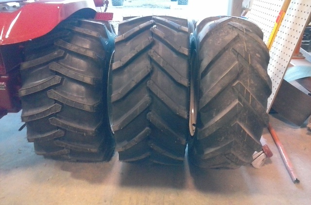

Thor27
I used a set of deere # 6256-14 wheels on my C160. They are 10.5" wide,  but the back spacing will not fit a horse with the tank under the seat.
I'd posted this in another tire thread so it was still handy to drag over here.
1. Firestone 23-10.50-12 on 10.5 deere rims, Miller recommends a 10.5 rim for these
2. Carlisle 23-10.50 on 8" 520H wheel, Carlile recommends an 8" wheel. With the deep dish of this wheel it sticks out of the fender farther and looks bigger, fender edge is roughly at the center line.
3. Deestone 23-10.50 on stock 7" C160 wheel, tire is the smallest of the 3.

DougL3
I prefer the look of the Deestone's myself.  You just answered the question I was going to ask about going narrower on my 416-8.
