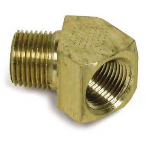

squonk 45,395 #16 Posted October 8, 2015 If it's a std. pipe thread, a 45 deg brass street elbow should do the job. Share this post Link to post Share on other sites
tommyg 155 #17 Posted October 8, 2015 Already looked at that idea. It's so tight underneath that filter housing. A 90 deg elbow won't work because it will hit the throttle linkage. I'll look one more time with a 45 in mind, but I have a hunch that's not going to work either. Share this post Link to post Share on other sites

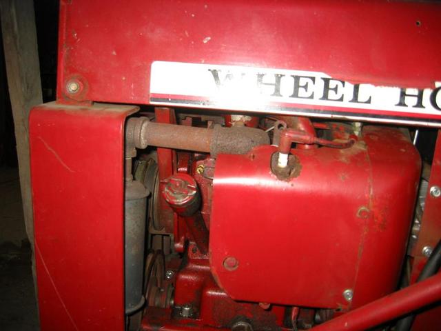

JackC 617 #18 Posted October 8, 2015 How about a picture of your engine and situation?As they say, there is usually more than one way to skin a cat.We have a ton of cat skinners in the membership.I am very interested because I would like to do the same thing you are trying to do.Are you working with a D-160 with the ONAN 16hp engine? Share this post Link to post Share on other sites

tommyg 155 #20 Posted October 9, 2015 Well, I thought I had it figured out. I installed a 1" brass straight fitting and then 90 deg fitting followed by a 4" brass tube. That allowed me to install the sender out from underneath the air filter. Feeling pretty proud of myself, I tightened the nut that held the wire to the sender and managed to twist the brass threaded pin in half. Didn't realize it was actually hollow. Took very little torque to pretty much destroy the new sender.I quit. I ordered the mechanical gauge that Paul recommended. Anyone want a VDO oil pressure gauge, I'll send you mine if you pay for shipping. You just need a new sending unit. (sigh) Share this post Link to post Share on other sites

pfrederi 19,808 #23 Posted October 10, 2015 Are you working with a D-160 with the ONAN 16hp engine? Nope. I actually re-powered my rig with a Kohler Command Pro recently. I forgot about your repower. I couldn't figure out why you had space issues with the sender. On the K series the port is wide open. I put a coupling in the oil line about even with the flywheel. Makes it easy to disconnect when you have to move the engine to work on the hydro pump and/or coupler. Something I have had to do way too often. Share this post Link to post Share on other sites
