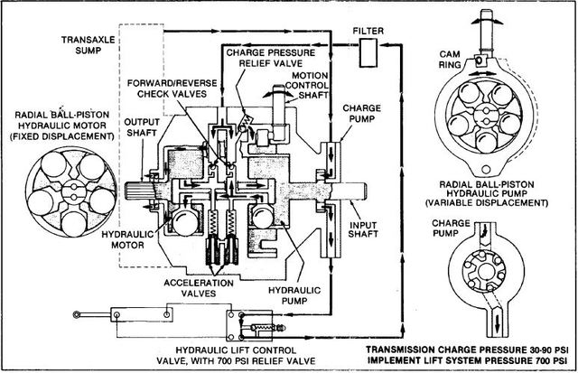

bmsgaffer 2,053 #12 Posted October 2, 2015 On a typical Eaton 1100, leaving the oil filter open a crack will work as the filter is mounted high up. I don't think that is the case on the xi. Everytime I have crawled under the machine, the filter is staring me in the face. Also, unlike the classic machines where you can easily remove the fender and seat to get at those "top bolts", taking the xi pan off can be a two person job, especially if you do it the way Toro suggests. I did read somewhere where someone put a soda straw down the fill tube to vent, but the fill tube is small to start with so you need to get the straw in there and still leave room for the oil to get down. Plus, you don't want the straw to get lost down the tube either. I will stand by my recommendation, warm up the oil. My first change was done in the month of November when it was somewhat cold. I had to pour the oil so slowly it took 20-30 minutes per quart and if you were not careful and tried to rush, the funnel just would not drain. Regardless of the oil filters physical location, it feeds the low pressure charge pump oil into the actual hydrostatic pump on the transmission (it is not connected to the sump so the level of the filter doesn't matter), so you may get some leakage from the pump/hoses but once that is cleared it will vent so you can safely refill with the oil pump loosened/off. This is the eaton 11 connection diagram: 2 Share this post Link to post Share on other sites
