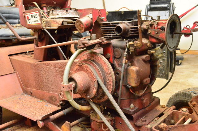

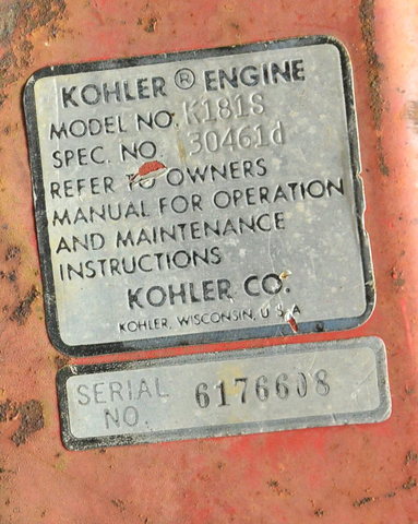

WHnoob 21 #1 Posted September 30, 2015 I recently acquired a free B-80 that had been sitting outside for a number of years. I forgot to check the exact model number but it is a 4-speed, making it a 1974 or 1975 based on the "Master Model List" (http://www.mywheelhorse.com/graphics/file/wheel_horse_products_master_model_list.pdf). It comes with a 36" rear discharge deck which apparently has been converted to side-discharge via a welded-on end from another deck.I was told the engine (K181 8 HP) was unusable and indeed was seized due to rust, so initially the plan was to borrow its transmission for my C-160 while its 8-speed undergoes a rebuild (broken High-Low selector fork, leaky seals). However upon pulling the head I found the piston was only ~3/8" from TDC and I was able to free it with some PB Blaster and a makeshift cheater bar on the flywheel. The valves were both stuck open (possibly the original reason it began sitting) but I was able to free them up as well by tapping them. It now turns pretty smoothly by hand so I think it may be easier to get this engine running than to do the transmission swap with the C-160. I'd like to try this without doing a full rebuild but have some concerns (like breaking the connecting rod). There is a slight ring of rust/carbon at the top of the cylinder sleeve (due to the position of the piston while it sat) but it doesn't seem to affect the piston travel and I think it is above the level of the top piston ring. The rest of the cylinder sleeve looks smooth and shiny. The piston rings may be stuck. I'm not sure that I saw the compression release working (exhaust valve is supposed to open slightly at ~2/3 up the compression stroke). Will the valves just get stuck again if I don't remove and clean/grind them?Also the rest of the tractor is missing a few parts: - Gas tank has been replaced with a birds nest. Local dealer quoted ~$140 for a new one, though I should be able to borrow the C-160's for testing. - Missing brake pedal and possibly the first linkage (pedal to jackshaft/lever) - Air cleaner cover and wingnut - Muffler - Lights (not really an issue, I'd rather rig up LED's anyway)If I remember I will try to get some pictures (though they won't be pretty ) and post the exact model information. Any advice on the engine or leads on the missing parts? 2 Share this post Link to post Share on other sites

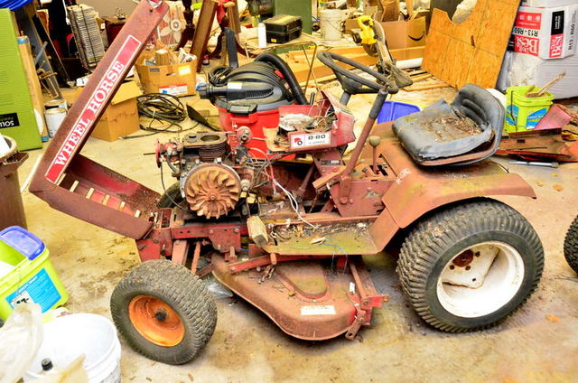

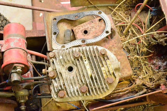

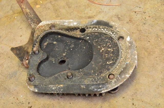

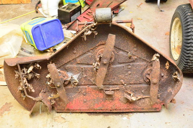

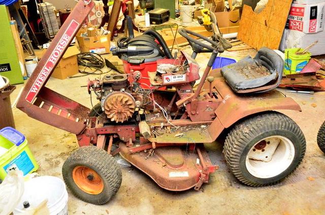

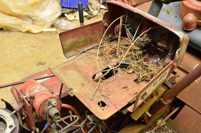

WHnoob 21 #12 Posted October 4, 2015 Thanks for all the responses! As promised (warned), I got some pictures today including a closeup of the top of the cylinder. If you look closely you can see the mud wasp tubes between the fins on the head! I think I will take Slammer's advice and at least clean the valves before attempting to run it. I'm hoping to avoid any major disassembly at the moment since my workshop is an unholy mess, but may plan for a teardown once the C-160's tranny is repaired.What do you guys think of the customized deck? It has both rear and side discharge! It is pretty well rusted through and missing some rollers but the spindles may be reusable. I didn't notice any grease fittings on it but also didn't look that closely or take the belt cover off.-Peter Share this post Link to post Share on other sites
slammer302 2,157 #13 Posted October 4, 2015 Looks like you have your hands full nothing a good cleaning can't fix. the blades on the deck look like new besides all the rust. Share this post Link to post Share on other sites

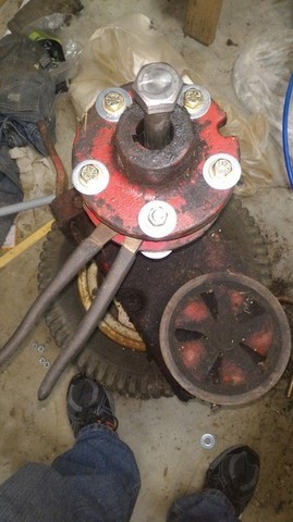

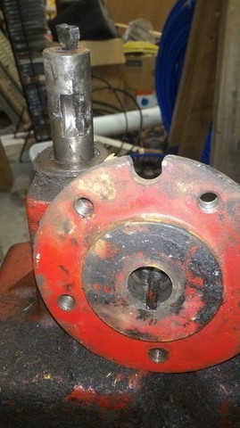

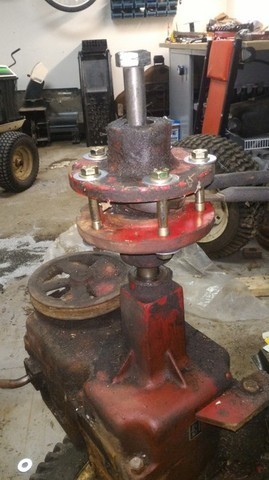

WHnoob 21 #14 Posted April 5, 2016 Figured I'd post a small update since it's been a while. I was able to pull the wheel hub with the damaged keyway using a hub from another transmission. The axle keyway is pretty munged up (almost 2x wider than normal), though the hub doesn't look too bad. And I got that exhaust nipple removed too. Ended up cutting a slot into it with a cutoff wheel up close to the block and bent it inward with a cold chisel and hammer. That was finally enough for the pipe wrench to turn it. Next step is to repair the axle keyway and reattach the transmission (that way I can at least push it out of the way . I'm leaning towards using some of the industrial axle repair epoxy to avoid splitting this tranny since I have the broken 8-speed from the C-160 to put in it eventually. Then once I have a workbench cleared I can pull the engine off for its overhaul. 1 Share this post Link to post Share on other sites
Ed Kennell 47,818 #15 Posted April 5, 2016 http://www.wheelhorseforum.com/topic/56859-key-way-fix/#comment-525605 I don't know if welding is one of your skills, but here is a link to the post where I repaired an axle keyway by making a brass dummy key and then laying in metal around the key. I did not remove the axle for the repair. I reshaped the welded area with a grinder, a file, high spot bluing and the hub as a gage. Share this post Link to post Share on other sites
WHnoob 21 #16 Posted April 5, 2016 Wow that repair looks great! And welding would seem to be the preferred method, though I've heard about the heat causing bending issues, etc. Unfortunately welding is not currently one of my skills - I did about 2 inches of MIG in college metal shop but that's about it. I'd like to learn but I'm guessing this would not be a great beginner project. Share this post Link to post Share on other sites
Retired Wrencher 7,036 #17 Posted April 6, 2016 WHnoob I had a C141 one time like that. If you are not good at and do not have a welder, I just used J.B. weld on it. shape it. Then tap hub back on for final shaping. It is still in service. Put key in 1st let it set. Then put on hub. Share this post Link to post Share on other sites
