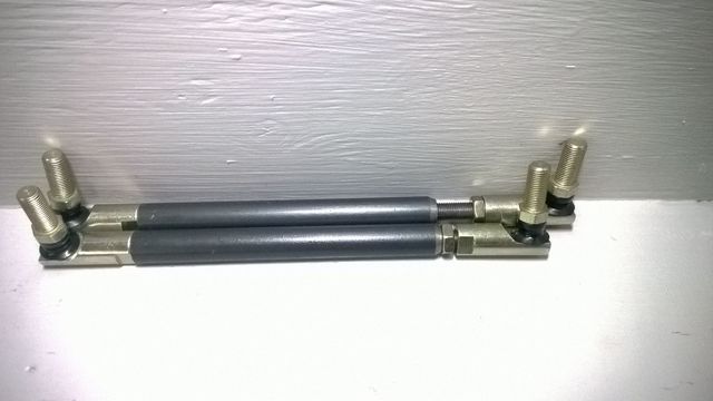

montess85 4 #1 Posted September 30, 2015 I'm going to dig into the front end of my 552. It has a bit of slop in the steering and spindles. Does anyone make new tie rod ends for this thing? They all have a bit of play. Also are there bushings in the front spindles? Share this post Link to post Share on other sites
GlenPettit 1,718 #2 Posted September 30, 2015 Take a look at "WheelHorseMan1000" down under Venders:see file: Share this post Link to post Share on other sites
