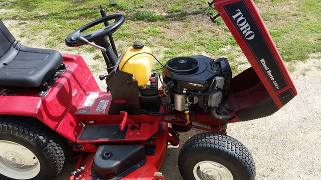

WHX?? 54,206 #8 Posted October 16, 2015 By any chance cheese did the lights flicker when at full throttle? My 246 has the same, voltage reads high butturning the lights on drops it but it seems when the battery gets fully charged the lights flicker. Turning on the electric pto drops the voltage more as expected. Replaced the regulator a couple of years ago from a Toro dealer. I do seem to go thru batteries every 2-3 years so maybe I am over charging. I should check it will a multimeter...I only have a dozen of them. 1 Share this post Link to post Share on other sites

WHX?? 54,206 #11 Posted October 16, 2015 I hear ya cheesy, I think I paid over 80 bucks for it from a dealer and that was at least 6-7 or better years ago. Fact I remember goin to pick it up thinkin it would be 20-30 flipped out my wallet and didn't have enough cash had to bounce a check!! Flea bay for 20??? now I gotta go look. Can you post a pic & p/n cheese? Dyin to know if its the same one?? Mine is on a Briggs v twin 18 hp i believe. Mounted just ahead of the starter I would think a 520 reg would be different Share this post Link to post Share on other sites

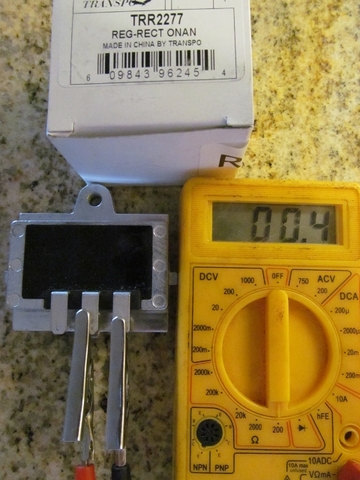

Ed Kennell 44,440 #12 Posted October 17, 2015 Hey Jim, here is the Onan reg I bought from Amazon for $19. 2 Share this post Link to post Share on other sites
WHX?? 54,206 #13 Posted October 18, 2015 Not the same as mine Ed but would work. Found a 394890 on fleabay for 14 bucks. Let you all know if it solves the problem. Definitely cooking the battery as it's low on water again. 1 Share this post Link to post Share on other sites
