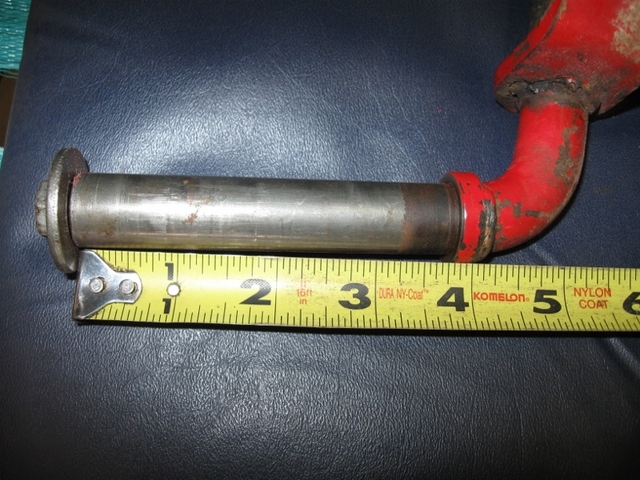

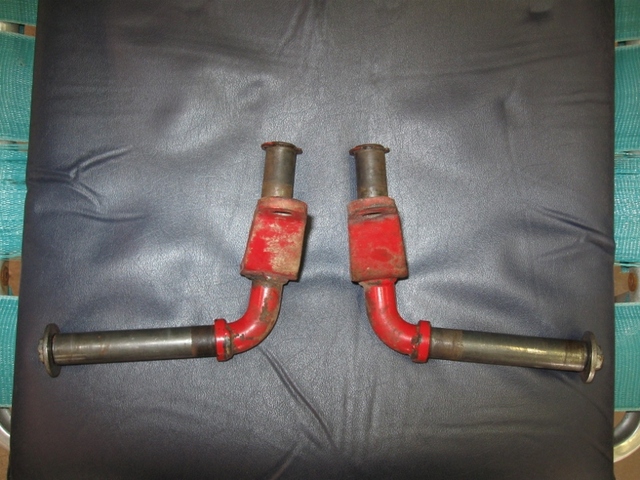

N3PUY 1,031 #5 Posted September 27, 2015 Here are pics of the 800 axles. Do they look correct? Share this post Link to post Share on other sites

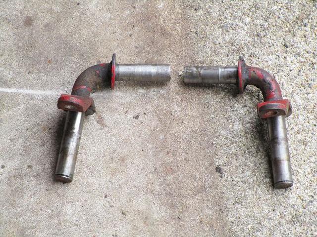

trainman 0 #9 Posted October 5, 2015 Ok here are the spindles I need they are shorter than the standard ones Share this post Link to post Share on other sites

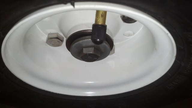

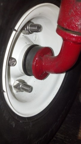

RedRanger 1,470 #12 Posted October 5, 2015 (edited) Ok here are the spindles I need they are shorter than the standard ones Based on that picture....I think those spindles would be fine with bearings.The Bearings will run on the outer most edge (doesn't look worn there) and about 1 inch inward of the inner flange.You might save yourself some cash and try bearings before buying more spindles???If the worn spot is still an issue, I'd even try some liquid metal and filing before replacing.Using those oiled brass bushings for spindle bearings was a terrible idea by WH.I'll get some pictures of my setup tonight after work for you.Edit-Adding pictures of my setup.I double checked and my brass spacers are 3/8" thick cut from the original oil brass bushings. Just used a bench vise and hacksaw/sawzall. Edited October 6, 2015 by RedRanger added photos 1 Share this post Link to post Share on other sites

RedRanger 1,470 #14 Posted October 7, 2015 (edited) I got the press in sealed bearings for the fronts off Ebay for what you said. Just one question could someone make new spindles with a lathe and just re use the tie rod brackets? RedRanger your photo's did not upload. They were there the other day. Had same issue in another thread that they disappeared in.As for machining new ones, anything is possible, for the right price. Edited October 7, 2015 by RedRanger 2 Share this post Link to post Share on other sites
