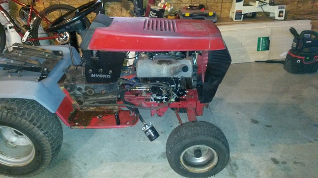

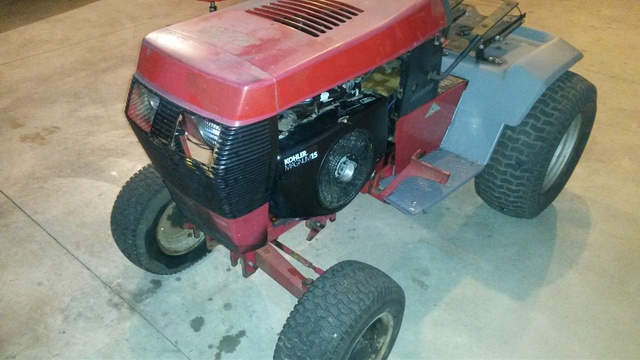

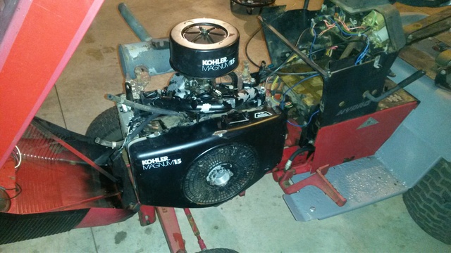

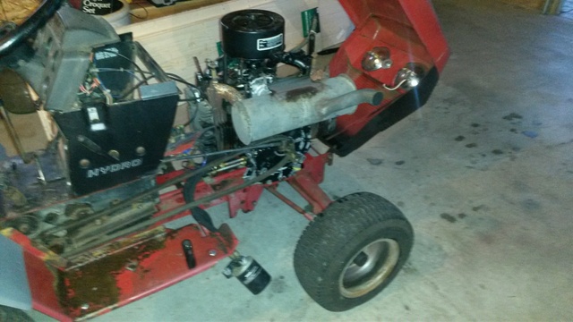

bds1984 1,506 #1 Posted September 26, 2015 (edited) Last night I picked up a "M18" for a song because a mouse had chewed off one of the high tension wires. The motor has 370 hours on it which I know is nothing and I'm loving the remote mount oil filter. It came out of a 1546 Cub Cadet and has Magnum 15 decals on it but is a M18S on the ID tag. So what gives? Is it just a disguise and really an 18 hp engine?I'm planning on putting it in my 520H roller for kicks.... Edited September 26, 2015 by bds1984 Pictures 2 Share this post Link to post Share on other sites

boovuc 1,090 #4 Posted September 27, 2015 If that is bolted down that really does look like it is suppose to be there from the factory. You wouldn't expect a "Non-Issue" with the exhaust going from different manufacturers!I wonder if the shroud and the air cleaner cover didn't come off of a vertical shaft Mag????? Share this post Link to post Share on other sites

bds1984 1,506 #7 Posted September 27, 2015 The engine is bolted in. It runs quite well but I need a 5.5'' engine pulley. All I had was a 4'' one I installed to at least test out the hydraulics. Everything works but is a but slow because of the smaller pulley.The engine came out of a cub cadet.... Share this post Link to post Share on other sites

gwest_ca-(File Mod) 11,974 #12 Posted September 28, 2015 Have heard of this happening. Say a tractor builder needed a 15hp 2-cylinder engine to meet market demands they would go to Kohler and they did not have one. It was not worth the expense to design and build a new engine to meet the spec so they would use a 18hp @ 3600 rpm and sell it as a 15hp @ say 3200 rpm and everyone was happy.Garry Share this post Link to post Share on other sites
Howie 900 #13 Posted September 28, 2015 Had a Briggs district rep say that is what they did when someone needed one that they did not make. David Share this post Link to post Share on other sites
diesel cowboy 263 #14 Posted September 28, 2015 Like the others said Cub Cadet wanted a 15hp engine to fill their line so they used the M18 and just had Kohler make the 15hp decals for it. That's why the model tag says M18. They also did the same with their 14, 16 and 17 hp lawn tractors Share this post Link to post Share on other sites

bds1984 1,506 #20 Posted October 2, 2015 The starter issue is fixed. A little bit of Fluid Film and some elbow grease has cured it. All I need now is an engine pulley from a 520H and it'll be set to work since the current 4" pulley setup turns slower, but it starts and runs well with 60PSI oil pressure at an idle so I cannot complain. I had to make my own wiring harness so I removed the complete tractor harness and indicator light assembly. Is that of any value to anyone? I wont be able to use anything powered by a traditional Wheel Horse PTO as this is a "bushing" engine as I just discovered from a manual I downloaded; makes sense as this came from a Cub Cadet and they don't have the side load like our WH's do. The crank is quite short so I don't have much room to put an electric clutch unless I can devise some sort of extension to bolt on the end of the crank. Any thoughts? Share this post Link to post Share on other sites
