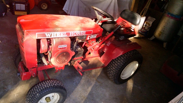

fishyc160 9 #1 Posted September 24, 2015 Hello guys this is my first post here. This C160 was my grand fathers and i just started the restoration. A nice coat of international red and some new decals. What do you guys think ? 7 Share this post Link to post Share on other sites
pacer 3,179 #2 Posted September 24, 2015 Some paint and decals and --- voila!! a new tractor, and it aint from a big box store and you can actually work on it yourself! Cant beat it. Good job ... and by the way, welcome to the madness of red tractors! Share this post Link to post Share on other sites
oliver2-44 11,214 #3 Posted September 24, 2015 You will enjoy that tractor more and more every time you use it. Share this post Link to post Share on other sites
AMC RULES 37,254 #4 Posted September 24, 2015 (edited) That looks so nice... it's plain to see, you're going to need more storage space. Edited September 24, 2015 by AMC RULES Share this post Link to post Share on other sites
squonk 45,531 #5 Posted September 24, 2015 I'm partial to the C-160's me self! 1 Share this post Link to post Share on other sites
953 nut 64,125 #6 Posted September 24, 2015 Love it when a stays in the family, hope your Grandfather is still with us, he will love it. Share this post Link to post Share on other sites
Ed Kennell 44,891 #7 Posted September 24, 2015 Those big thumpers are the Bomb. Share this post Link to post Share on other sites
Wishin4a416 2,473 #8 Posted September 24, 2015 Nice to keep it in the Family. Good job!! Share this post Link to post Share on other sites

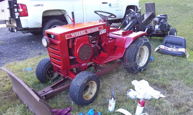

infernus 8 #12 Posted September 30, 2015 Looks good. DId you use any filler? Did you DA the panels? I need to do this to my C160, and I have some pitted rust in the hood near the muffler. I'm not confident that glaze putty or bondo is going to hold up to the heat of that muffler. Share this post Link to post Share on other sites

fishyc160 9 #19 Posted November 16, 2015 And hardly any filler. I was lucky to have minimal rust. Just small pits everywhere on the hood and fenders. I sanded to bare metal and applied a layer of bondo. Then hit it with 80 grit to take it down to bare metal again minus all the valleys that were filled. Here is the first bondo application Share this post Link to post Share on other sites
953 nut 64,125 #20 Posted November 16, 2015 Using a plastic filler directly over old paint is never a good idea. Some fillers are part of a coating system that are applied over a compatible primer, others are intended to be applied directly to prepared metal surfaces. When the hood sits in the sun and heats up the adhesion between the old paint and the filler may fail. Be sure you are following the instructions for the product you are using. Also, you will want to remove all of the residual adhesive from the decals, 3M and others make some great products for this.We all want your project to be a real success. 2 Share this post Link to post Share on other sites
