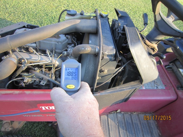

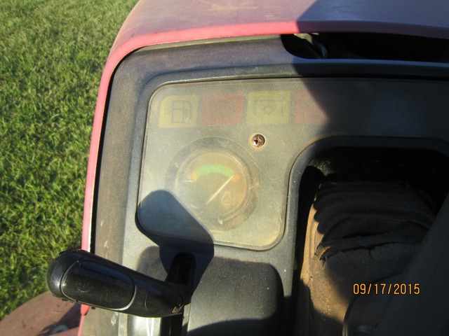

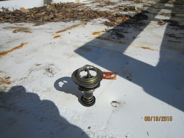

bluebug 27 #1 Posted September 23, 2015 (edited) My 523Dxi was running real warm. The indicator was all the way to the top of the green bar.I tested it with a digital thermometer and it was reading 194 at the thermostat housing. Which is not much more than one would expect at that location.I ordered and replaced the thermostat and the temperature sending unit. Thermostat was stuck open.It is running some cooler now but I have not run it longer than 20 minutes and have not cut grass with it yet. I will recheck when next I cut and post some more pictures. Edited September 23, 2015 by bluebug 1 Share this post Link to post Share on other sites

bluebug 27 #7 Posted September 23, 2015 Yes, air flow is from the radiator forward to the front of the tractor.The thermostat was stuck but entirely in one piece.Clark Share this post Link to post Share on other sites
