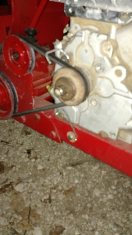

stevasaurus 23,861 #33 Posted September 24, 2015 Here is an option until you get that belt guard. You can bend the wire to funnel the slack in the belt toward the engine pulley. This works great until you find a belt guard. 3 Share this post Link to post Share on other sites

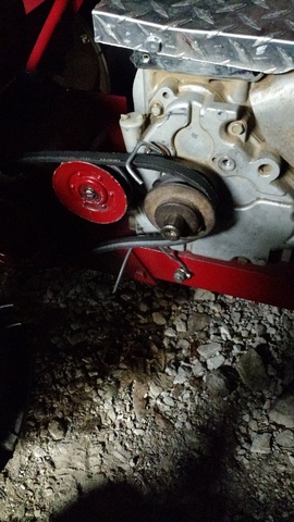

Brian01 481 #38 Posted September 25, 2015 lol...I'm out here in the shop right now, trying to build the "guides" for it 3 Share this post Link to post Share on other sites
Brian01 481 #39 Posted September 25, 2015 Not the prettiest, but so far, is functioning as should... 3 Share this post Link to post Share on other sites

Racinbob 13,250 #42 Posted September 25, 2015 As long as you're getting the belt to stop you'll be fine. Well, just watch your pant legs, fingers....... 2 Share this post Link to post Share on other sites
Brian01 481 #43 Posted September 25, 2015 lol yeah, for sure. It's stopping, for now anyway, really need "thicker" guide rods...I use pegboard hangers to build these, they are just a little flimsey. But not bad Share this post Link to post Share on other sites
stevasaurus 23,861 #44 Posted September 25, 2015 Go to ACE or TSC and buy some sturdier rod. Looks like you have them in the right place. They should be about 1/4" away from the belt when the belt is under tension. Looks good Brian and at least you can ride it without hurting that trans. Share this post Link to post Share on other sites
