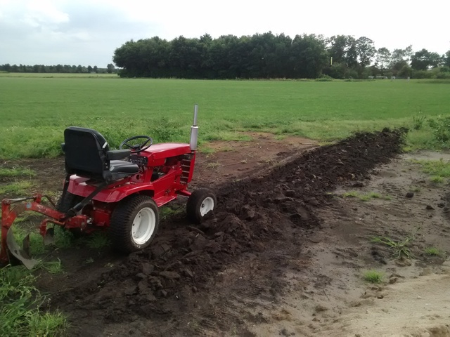

C-101plowerpower 1,606 #3 Posted September 21, 2015 (edited) I know, that's why i'm using them turning pieces of earth upside down. Sorry for the confusion Edited September 21, 2015 by C-101plowerpower 3 Share this post Link to post Share on other sites

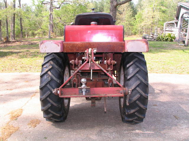

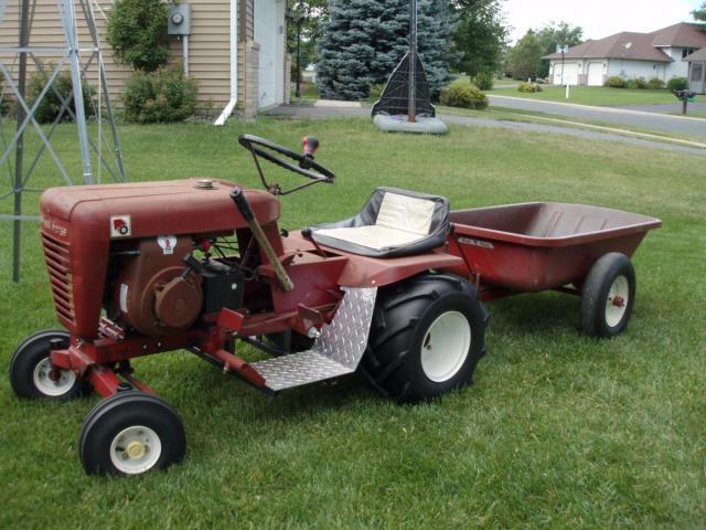

pacer 3,177 #11 Posted September 21, 2015 This is my "down & dirty" D-160 work horse. Used almost exclusively for pulling yard trailer and dragging logs etc. I have some hilly areas and before ags with turfs I was constantly spinning/slipping/getting stuck. I was simply blown away at the difference in traction after ags! They are 15"s so cant comment as to brands on 14s. 6 Share this post Link to post Share on other sites

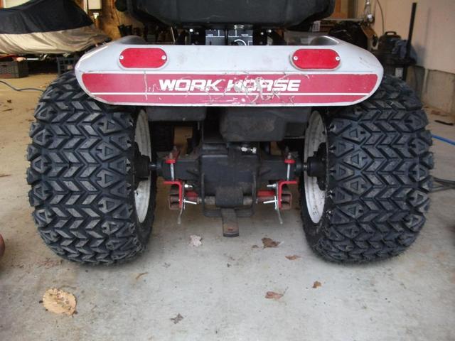

Terry M-(Moderator) 2,222 #12 Posted September 21, 2015 (edited) I'm slowly adding ag's to all of my Wheel Horses.... excellent traction on grass and snow. Edited September 21, 2015 by Terry M 5 Share this post Link to post Share on other sites
C-101plowerpower 1,606 #13 Posted September 21, 2015 that looks like a fine specimen Pacer Share this post Link to post Share on other sites

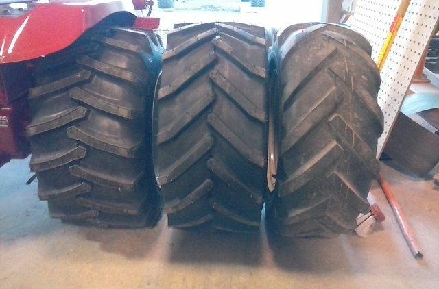

Thor27 835 #14 Posted September 21, 2015 For comparison, Left to right, Firestone, Carlisle, and Deestone all in 23-10.50x12 In fairness, the firestones are on a 10.5 wheel, the carlisles are on an 8.5, and the deestones are on a 7.5, which is plenty wide for them. 8 Share this post Link to post Share on other sites

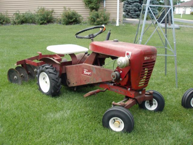

slammer302 2,156 #17 Posted September 21, 2015 Terry M I put the same tires on my lawn ranger and it turned it into a great little worker Sent from my XT1080 using Tapatalk 1 Share this post Link to post Share on other sites

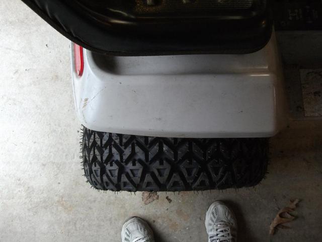

Sparky-(Admin) 23,082 #23 Posted September 22, 2015 Here is what I run all year. They are great in the snow with wheel weights and no chains.Mike........... 5 Share this post Link to post Share on other sites
