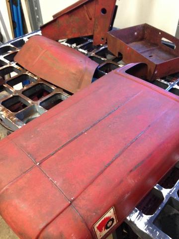

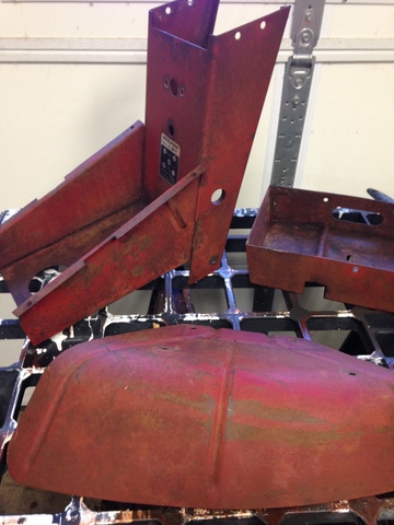

Brad GREENWALD 13 #1 Posted September 19, 2015 working on my 753 had a lot of surface rust wd40 and sanded it just wondering if i put clear coat paint on it or leave it Share this post Link to post Share on other sites
