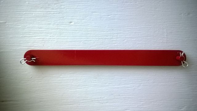

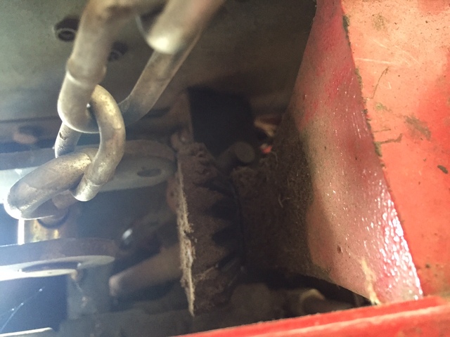

WNYPCRepair 1,924 #1 Posted September 19, 2015 Does anyone have one of these on a 520-H? My lift arm hits the steering gear without the lift link, after I install it it really hits, it actually moves the steering gear. Something is screwy. Share this post Link to post Share on other sites
rick 270 #2 Posted September 20, 2015 I believe the solid link should be offset, mine is. It clears everything on my 300, 400 models Share this post Link to post Share on other sites
WNYPCRepair 1,924 #3 Posted September 20, 2015 I figured this out, though the lift bar still hits. The he solid lift link doesn't hit if it moves straight up and down. Without the Extension kit for the 520, the lift hole on the plow is too far forward. I fabricated an extension and it works great. 1 Share this post Link to post Share on other sites
bmsgaffer 2,069 #4 Posted September 21, 2015 There's a service bulletin out there somewhere on this... Ah, yes... here it is:http://www.wheelhorseforum.com/files/file/1524-toro91-presgt-gt08-50in-grader-blade-on-1991-1992-520-hpdf/ 1 Share this post Link to post Share on other sites
WNYPCRepair 1,924 #5 Posted September 21, 2015 That is for the mid grader blade, but same difference. After I extended the lift point rearward, the lift link no longer hits, but the tractor's lift arm still hits slightly, and there is no way to move it. It doesn't appear to hit enough to hurt anything, as it doesn't look worn. Share this post Link to post Share on other sites
