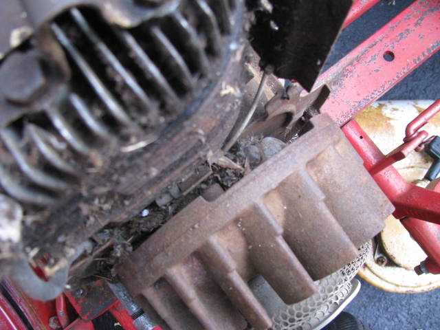

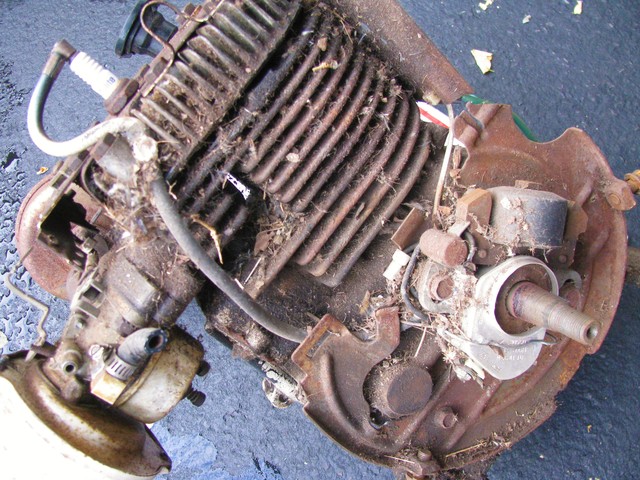

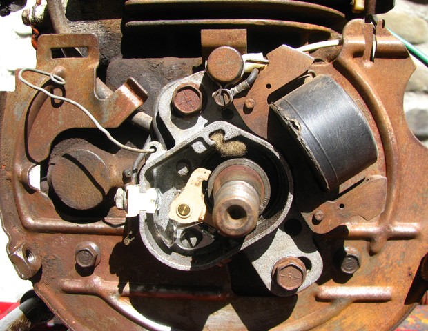

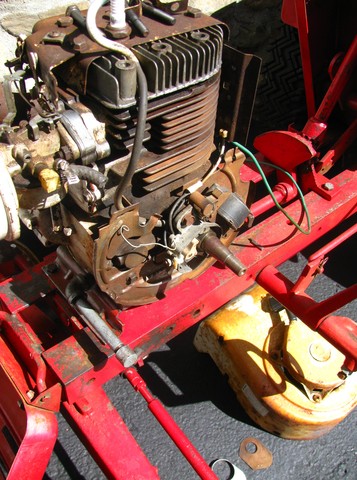

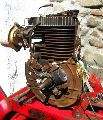

Retired Wrencher 6,914 #29 Posted September 13, 2015 Pretty much, all back together now... just got a no spark issue to deal with...but I think it's because of the mouse hotel all packed in behind the engine tins. Just had to call the game because of rain. Wow Craig Less than 12 hours and she is ready to work. The spark is easy fix parts are cheap Just saying from one Tecky person to another. But I found out that the notch on the cheap coils are junk = the notch on top of the coil is not high enough to hold the clip in place. that is what happen when I bought one. so went to a oem part. Enjoy looks like you are almost there. I have an extra dash if you need one. Share this post Link to post Share on other sites

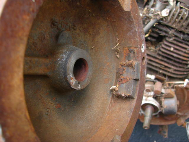

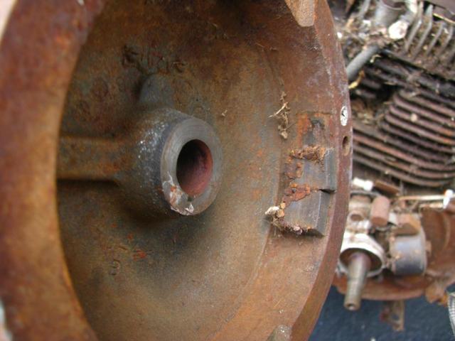

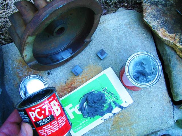

AMC RULES 37,259 #30 Posted September 14, 2015 Welp... it's back to being a roller again. Popped the blower housing off today...see if I could get away easy, just clean out the nest.found the back of it was chock full of nest, to include one dried up mouse. Decided to romove the flywheel...only to find one of the magnets missing too. Going to take the block to work with me tomorrow, give it a steam bath. Never had to venture this far into one to get it running... is the missing magnet is going to be issue...run again, with one of 'em missing? 2 Share this post Link to post Share on other sites
953 nut 68,442 #31 Posted September 14, 2015 Had a mower years back that had no spark after a long winter storage, turned out the points gap was open when stored and a bug nest under the flywheel held them open. Wish all my problems were that easy to solve. 1 Share this post Link to post Share on other sites
AMC RULES 37,259 #32 Posted September 14, 2015 If nothing else... I'll get this one cleaned up, put back together...give it a yank, and see what happens. At this point, I've got nothing to lose here. 2 Share this post Link to post Share on other sites
squonk 47,885 #33 Posted September 14, 2015 I believe you will need the missing magnet. Share this post Link to post Share on other sites
AMC RULES 37,259 #34 Posted September 14, 2015 Know of a source for missing magnets Mike? 1 Share this post Link to post Share on other sites

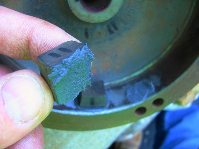

Terry M-(Moderator) 2,311 #35 Posted September 14, 2015 I believe you will need the missing magnet. Know of a source for missing magnets Mike? I see the magnet.....is there a way to glue these on?? 1 Share this post Link to post Share on other sites

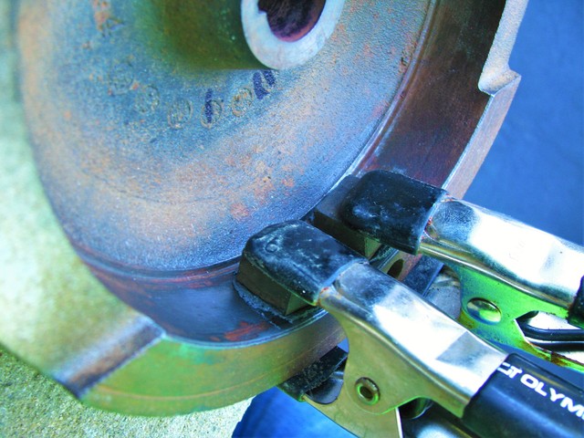

AMC RULES 37,259 #36 Posted September 14, 2015 (edited) OH...is that it there attached to to other? No wonder, all the other flywheels I saw...only had two on 'em. Good eye Terry...should epoxy back into place, no problems. Edited September 14, 2015 by AMC RULES 2 Share this post Link to post Share on other sites
woodchuckfarmer 333 #37 Posted September 14, 2015 JB Weld works good for that. 2 Share this post Link to post Share on other sites
Terry M-(Moderator) 2,311 #38 Posted September 14, 2015 Your welcome Craig....tecumseh H60 and HH60 manual /pull start only engines use only two magnets. 1 Share this post Link to post Share on other sites
slammer302 2,157 #39 Posted September 14, 2015 I think i have a flywheel if that one doesn't work out for you 1 Share this post Link to post Share on other sites
AMC RULES 37,259 #40 Posted September 14, 2015 You guys are the best. 1 Share this post Link to post Share on other sites
Retired Wrencher 6,914 #41 Posted September 14, 2015 JB Weld works good for that. I was thinking the same thing get good and clean put some J.B. on it should be fine. Liquid steel a farmers friend. Good stuff. 2 Share this post Link to post Share on other sites
AMC RULES 37,259 #42 Posted September 15, 2015 Baby steps today...engine cleaned up, magnets back in place. Allow 24hrs to dry...then we'll see if the little indian that could, actually will run again. 4 Share this post Link to post Share on other sites

AMC RULES 37,259 #49 Posted September 27, 2015 (edited) Was gifted once again today... new plug, points, condenser, and with the third pull...the 500 Special's good little Techy came back to life. Edited September 27, 2015 by AMC RULES Share this post Link to post Share on other sites
