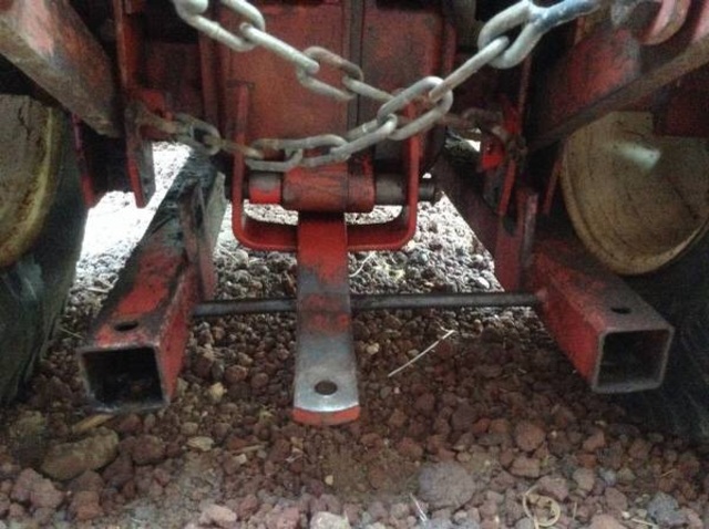

i was looking over my new horse and noticed the undercarriage mount at the rear is misaligned and appears to be missing bolts or pins?,got all the manuals with tractor but none show a good view or diagram,anyone have pictures or know what secures it,will have to loosen frame and realign first,thx.

The flanges on the frame should be inside the 3 pt brackets.  Not a great picture but i had it available. you can see the bolt through the 3pt then the mounting frame.

Thanks so much,figured that's how it bolted up,thought maybe pins but that helps me out,the FEL frame flanges appear to be oblong,might just be wallowed out,does it bolt tight or should it be allowed to move some?flex?,thx again.

Bolt tight, but do not collapse the 3pt brackets. I think the oversizing was to help with alignment these are not precision units
