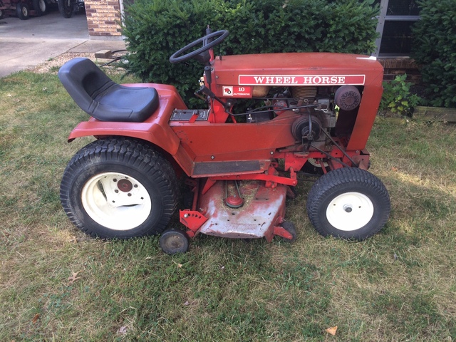

Here is a picture of the deck installed.  Yard is so dry that it's gone a little dormant but I mowed anyway.  I did figure why the deck isn't lifting and lowering properly.  The front hanger brackets have an angle on them so the foot boards clear and they were originally installed reversed so that the angles point towards the front of the tractor.  The PO must have used it like this forever and just dealt with it.
