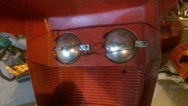

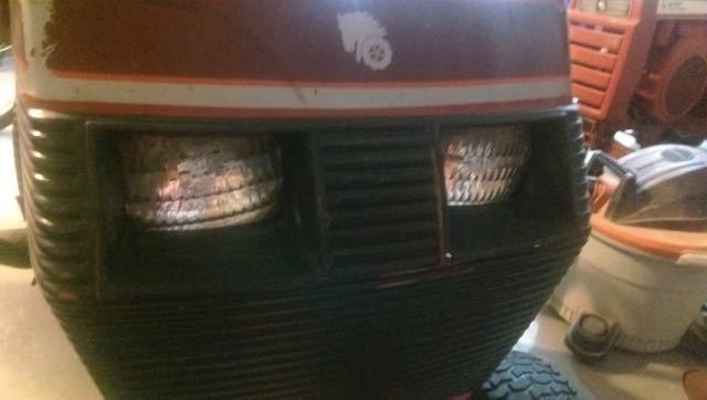

Ah shoot, photos somehow got lost in the original post.  Here they are.. front one is a bit dark, I could take a better one tomorrow.
On the inside, as you can maybe see in the photo, the light is just loose and held by some tabs and the single screw bracket.  I can rattle them quite a bit and spin them around freely (as far as the wires will go at least).

Looks like the bezels are there and the inside hardware looks correct. Might have to bend those 2 metal screw in clips that hold the bulb in the back. They should be a bit taught. Others will shout out.  Will be following along.
glenn
squonk
 Take out the bulbs. bend the 2 metal tabs on each hole in so they hold the bulbs tighter. Reinstall. 10 min and your rattle free.

Wow, yep, bending the tabs made a wold of a difference.  No more rattle!  I've gotta say, when I first fired up the horse I thought something major was wrong - can't believe the previous owner lived with that for so long!
