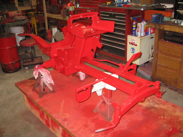

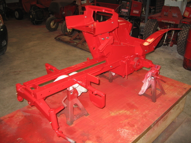

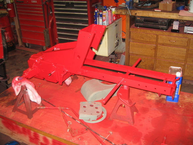

Shynon 7,728 #53 Posted November 26, 2015 Had a chance to do a little painting on Monday 6 Share this post Link to post Share on other sites
JPWH 6,544 #54 Posted November 26, 2015 Looking real good. Spray gun or rattle can ? That's the part I'm dreading. I am not a good painter. 1 Share this post Link to post Share on other sites
Shynon 7,728 #55 Posted November 26, 2015 10 hours ago, Hank01 said: Looking real good. Spray gun or rattle can ? That's the part I'm dreading. I am not a good painter. Harbor freight HVLP gun, Sherwin Williams Sher Kem IH Red 3 Share this post Link to post Share on other sites
jeremi3210 759 #56 Posted November 26, 2015 Looks good Tom, can't wait to see the finished product. 1 Share this post Link to post Share on other sites

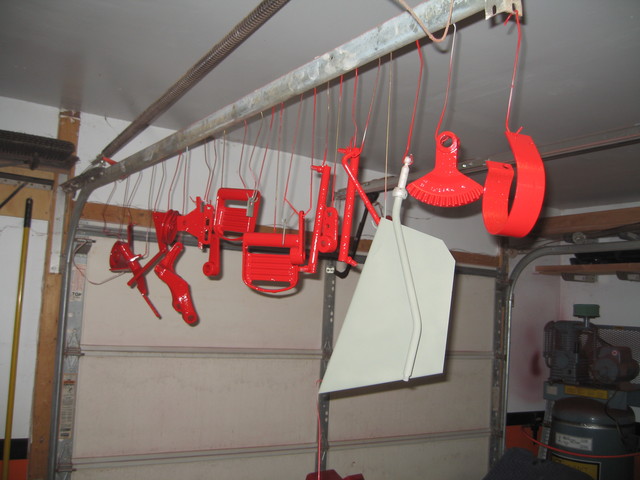

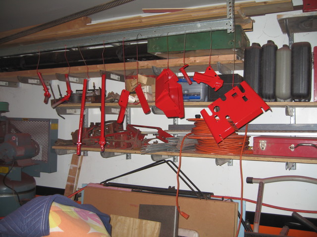

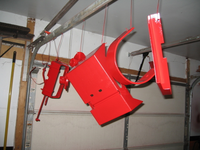

RedRanger 1,470 #57 Posted November 29, 2015 Amazing how well garage door tracks work as paint racks. I just hate the over spray on everything. 3 Share this post Link to post Share on other sites

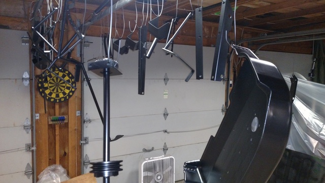

Bach-Ed 170 #58 Posted November 30, 2015 I used to get overspray everywhere. But I saw online at one of my wood working sites a simple solution. A cheap spray booth. I got some 4 mil plastic and 8 pieces of 2 x 2. Cut a notch in the 2 x 2s at the center, about an inch wide and 1/2 deep. Staple plastic (on the notched side) to four of the 2 x 2 and attach notched side up to your ceiling. You can use a piece of wire laid in the notch but better is a velcro strip to secure the plastic when you roll it up. On the bottom cut the plastic to length (a little longer than the distance to the floor.) and staple the other 2 x 2s. This weighs the plastic down and when done with the spraying use these to roll up the plastic. When not in use it's up against the ceiling. USE a respirator! the stuff can get thick in there or ventilate it. Oh and if there is a garage door opener be sure to un plug it, if someone comes home unexpectedlyyou don't want to find out what will happen. 3 Share this post Link to post Share on other sites
RedRanger 1,470 #59 Posted November 30, 2015 2 hours ago, Bach-Ed said: I used to get overspray everywhere. But I saw online at one of my wood working sites a simple solution. A cheap spray booth. I got some 4 mil plastic and 8 pieces of 2 x 2. Cut a notch in the 2 x 2s at the center, about an inch wide and 1/2 deep. Staple plastic (on the notched side) to four of the 2 x 2 and attach notched side up to your ceiling. You can use a piece of wire laid in the notch but better is a velcro strip to secure the plastic when you roll it up. On the bottom cut the plastic to length (a little longer than the distance to the floor.) and staple the other 2 x 2s. This weighs the plastic down and when done with the spraying use these to roll up the plastic. When not in use it's up against the ceiling. USE a respirator! the stuff can get thick in there or ventilate it. Oh and if there is a garage door opener be sure to un plug it, if someone comes home unexpectedlyyou don't want to find out what will happen. I've considered doing just that. The way my shop is set up, it is just easier at this time to cover everything else with plastic, open the garage door about the height of a box fan and close off around the fan with plywood. Instant exhaust fan. Only down side is I ended up with a red driveway in front of that door this time. If I was spraying more often or my shop was finished, I'd surely build a makeshift booth. 4 Share this post Link to post Share on other sites

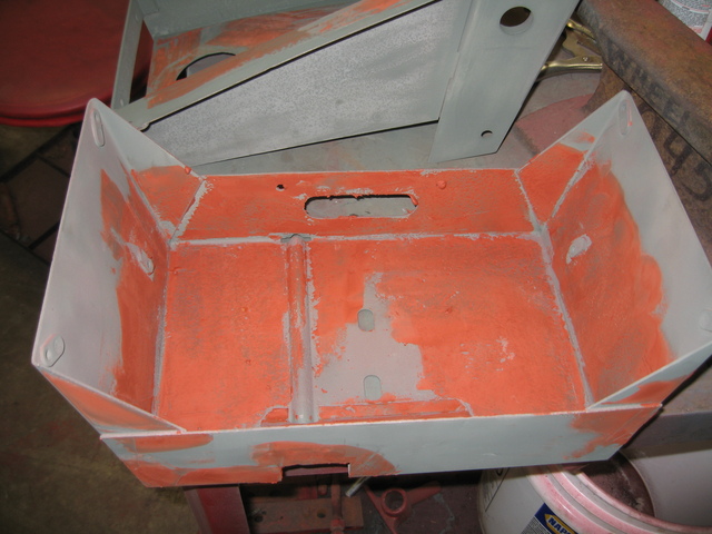

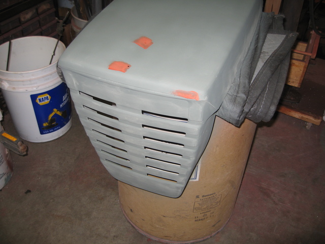

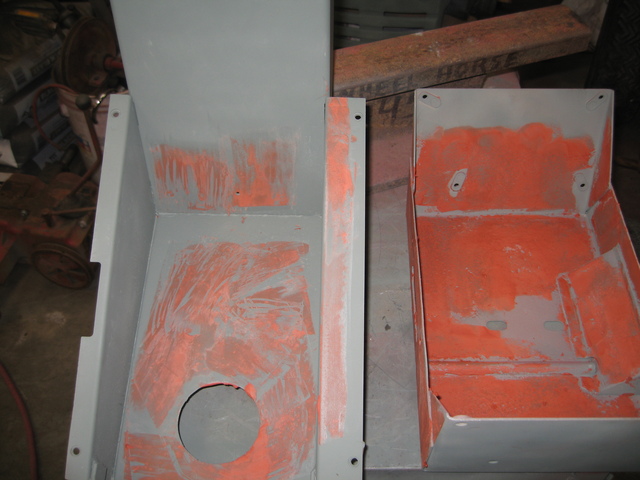

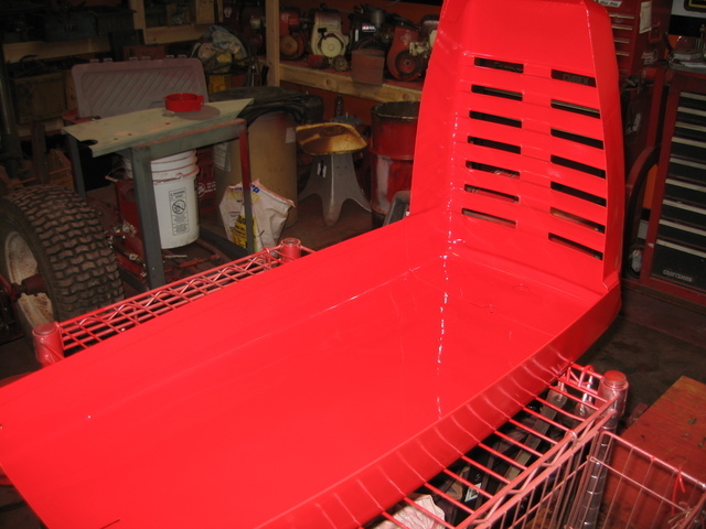

Shynon 7,728 #60 Posted December 22, 2015 Spent some more time working on the 1045, more primer and spot filler for the rust pits, hoping to do some more painting on this week. 6 Share this post Link to post Share on other sites

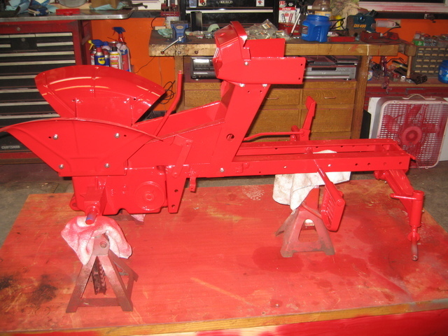

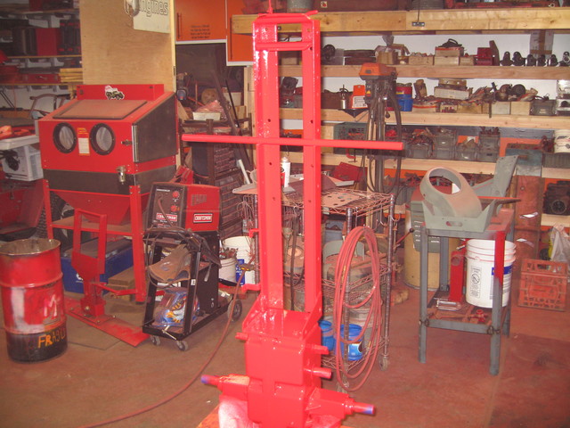

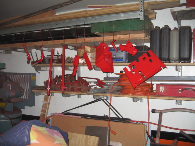

Shynon 7,728 #61 Posted January 7, 2016 Little painting done, may start some assembly soon. 9 Share this post Link to post Share on other sites
JPWH 6,544 #62 Posted January 7, 2016 Looking real nice! 3 Share this post Link to post Share on other sites
Mike'sHorseBarn 3,704 #63 Posted January 8, 2016 Looking great! I'm getting excited to see it finished!! 1 Share this post Link to post Share on other sites
953 nut 70,077 #64 Posted January 8, 2016 Always love to see fresh red paint. 1 Share this post Link to post Share on other sites

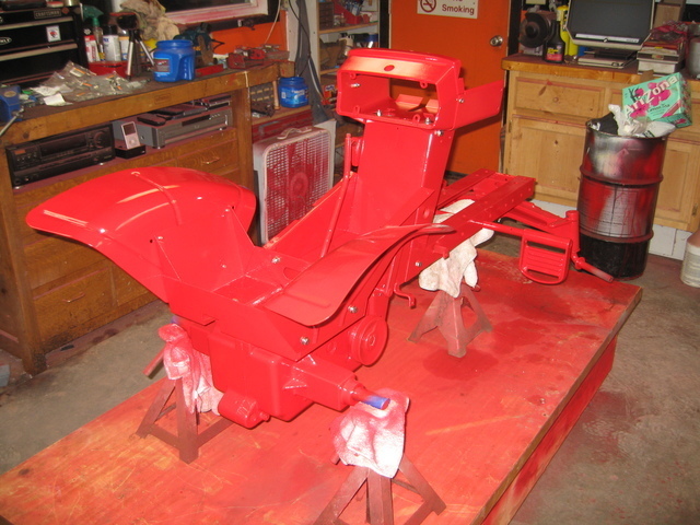

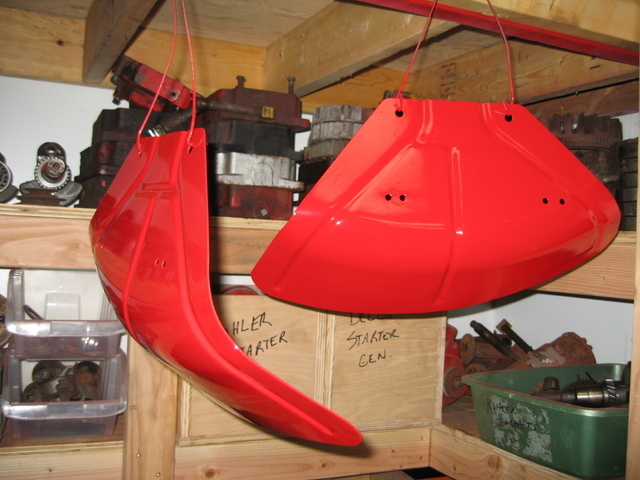

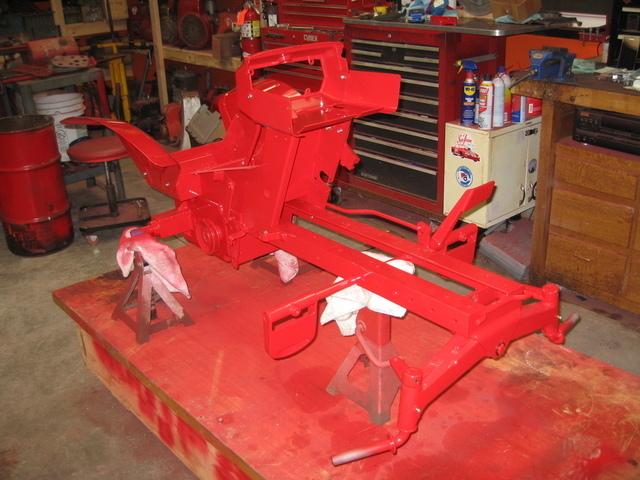

Shynon 7,728 #65 Posted January 17, 2016 Little assembly done, until I ran out of painted parts and stainless hardware. Need to blast the tank and lift lever. Have NOS kohler 10 waiting to go on this one. Hopefully soon. Just noticed in the pics the two holes in the gas tank support that will need to get fixed. 10 Share this post Link to post Share on other sites
