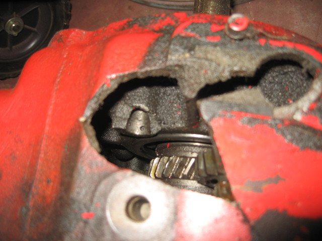

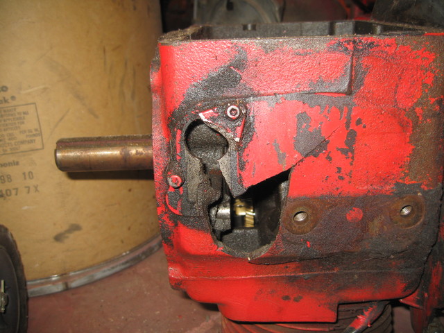

MalMac 1,336 #2 Posted September 7, 2015 The balance gears are the two smaller half moon gears that are on two separate studs. On the k301 you can take them out. The old K series are better off without them. There is s reason they call them grenade gears. When they or their bearings wear, they find ways to make a exit out of the motor. Usually by creating there exit hole. 2 Share this post Link to post Share on other sites

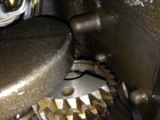

Horse46 519 #5 Posted September 8, 2015 OK I'm with you now, each one is a whole and two halves, I thought the two half gears were the balance gears.In the picture is 1 balance gear right? Share this post Link to post Share on other sites
