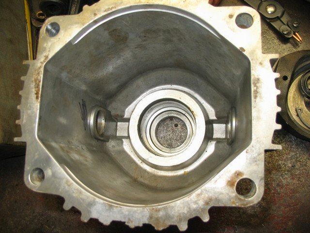

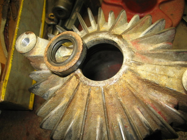

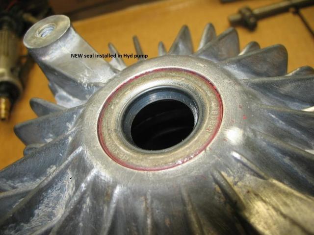

daveoman1966 3,841 #2 Posted September 5, 2015 (edited) Try this.... 1) remove the connection -to-engine link enough to thoroughly clean off the pump shaft. 2) find a short piece of PVC pipe to fit over the shaft and drive the old seal in about 3/8 or 1/2" or so...3) using that same PVC, push a NEW SEAL right over top of the old seal, without removing the old. The new seal should slightly recess the edge of the housing..If you can't drive it in 3/8" or so...you'll have to pick it out. That is much easier that tearing dwon the whole thing, just to replace the seal.I suggest this because...if it works, what an enormous work and time saver. If it doesn't little time is lost in trying.... There is a shaft bearing, of course, but it is in at least an inch from the end of the housing. To drive the old seal further into the housing...nothing wrong with that...IMHO, that is. These pics are of a Sundstrand pump in a D-180 that I rebuilt a couple years ago. The TIMKEN seal 48021 for about $7 is a perfect match. Edited September 5, 2015 by daveoman1966 2 Share this post Link to post Share on other sites

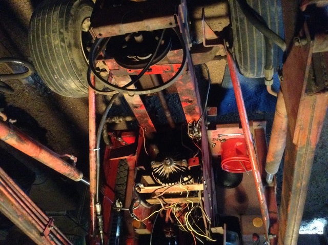

Sea-Duck51 55 #8 Posted November 5, 2015 I got the seal but now can anyone suggest the best way to repair,do I need to pull the pump out or?,was thinking about un bolting and sliding the motor forward,anyone done this and have some thoughts,thx. Share this post Link to post Share on other sites
Niagara D 11 #9 Posted November 5, 2015 From my experience trying to get at the pump it's easier to pull the motor than to pull the pump. 2 Share this post Link to post Share on other sites
Sea-Duck51 55 #10 Posted November 5, 2015 I think your right,after studying all my options I'm going to pull the motor or at least slide it forward,don't really want to remove mufflers so thinking of unbolting the front shroud frame,just need enough room to get the coupler off and tap the new seal in. Share this post Link to post Share on other sites
Niagara D 11 #11 Posted November 9, 2015 Yes to avoid muffler removal you can take off the hood and front support then you can slide the motor as far forward as you need. I pulled a pup out by taking apart the column and after realized a better way. I have to replace the o rings on the line set at the pump on one of mine this winter and I feel it's likely going to be easier to just yank the engine to get it done. Share this post Link to post Share on other sites
Sea-Duck51 55 #12 Posted November 9, 2015 Yes to avoid muffler removal you can take off the hood and front support then you can slide the motor as far forward as you need. I pulled a pup out by taking apart the column and after realized a better way. I have to replace the o rings on the line set at the pump on one of mine this winter and I feel it's likely going to be easier to just yank the engine to get it done. You are absolutely right,bolts that are behind the muffler pipes are a bit tricky but was able to take the support off and went ahead and pulled the motor out of the way,seal should be here any day and then the reassemble fun begins,will give me a chance to clean up the frame,snow is starting to fly today and garage is un-heated with a dirt floor,just bought the place and didn't get a floor poured before weather turned so have to wait till spring. Share this post Link to post Share on other sites
Sea-Duck51 55 #13 Posted November 10, 2015 One step forward two steps back...ugh so after removing the old seal which btw wasn't difficult,it wouldn't drive in so out it came,prepped for the new seal,emery cloth and as I started to drive it in the rubber lip caught on a burr and tried to roll over,used a pick and fixed it but now have decided after throughly filing,sanding the offending shaft have ordered another seal,going to drive the first one in and install another,two is always better than one,on a side note discovered one of the studs on the intake was boogered so ended up taking off the mufflers,came off like easy as can be,oh well so much for removing the front support,least it will go back together much easier!. Share this post Link to post Share on other sites
