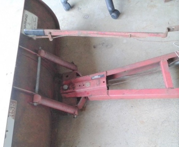

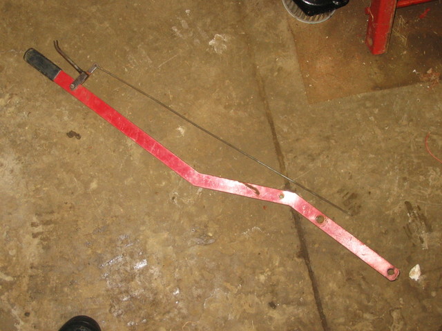

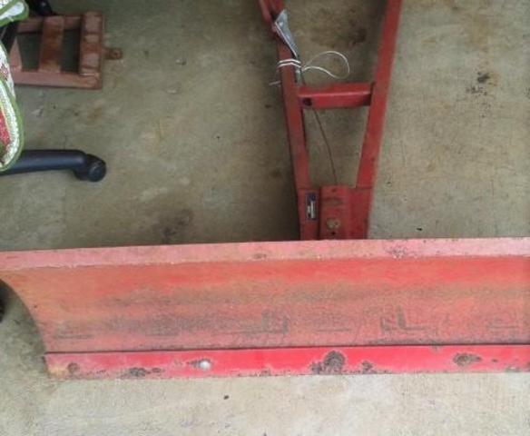

BOB ELLISON 2,983 #1 Posted September 3, 2015 Just got a wheel horse snow plow from a 310-8 and the numbers are 96-42BC01-05704.what do I need to do to makethis work on my 1995 520h ,I know I need a extension for it but will it work at all for my tractor ? I got the rear axlebracket and the plow for $100.00. couldn't pass it up. it is a little rusty but it will clean up good. nice blade not bent. Even thought I will go tomorrow and buy a c160 with a plow, chains and weights for a couple hundred dollars .in lotbetter shape then the one I'm redoing ,might have to redo this one to . dong wheel horse's I got the bug bad, in 3 weeks ill have 4 wheel horse's and 2 plows, dang wheel horse's Share this post Link to post Share on other sites
shallowwatersailor 3,221 #2 Posted September 3, 2015 (edited) I believe that it will attach to a 520-H with the swept axle, but you won't be able to sector it. Edited September 3, 2015 by shallowwatersailor Share this post Link to post Share on other sites

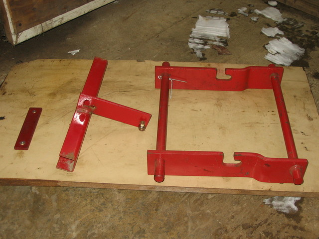

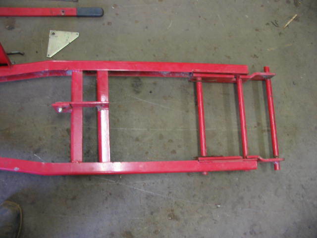

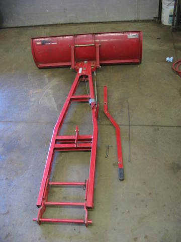

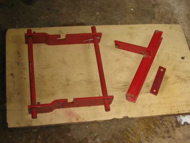

daveoman1966 3,884 #4 Posted September 3, 2015 You need these two extension brackets.... and a different index lever (long red lever). 1 Share this post Link to post Share on other sites

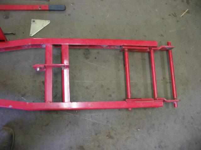

DennisThornton 4,773 #5 Posted September 3, 2015 Shove it out front but then even the lever needs modding! OK! I see it now.I love pics, (don't we all!) and this one screams for one more. Anyway to get a side shot of the extender and some description of the notches? And I'm a bit fuzzy on the T bracket to the right...Great quick reply and with pictures! Share this post Link to post Share on other sites

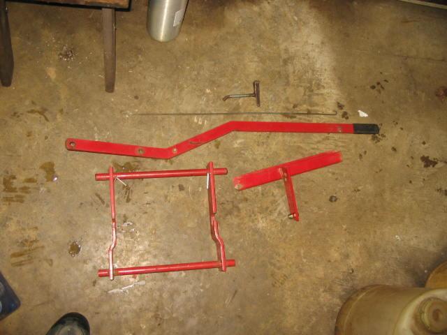

daveoman1966 3,884 #6 Posted September 3, 2015 more pics... 1 Share this post Link to post Share on other sites

BOB ELLISON 2,983 #8 Posted September 3, 2015 FYI....I have an NOS snow blade and all brackets (as pictured above in daveoman's post) plus NOS rear axle bracket....made for the 520H tractor...guess I might as well sell it if you happen to be in Missouri as I will not ship it.....$500.00....send me a pm if interested.I might even fix ya up with a 520H w/60" deck if you bring a BIG trailer!! Bowtieguy you are to far for me ,but thanks anyways You need these two extension brackets.... and a different index lever (long red lever). daveoman1966 can you send me some measurements of the two extension brackets and the index lever .ill try to make them.the extension for the a frame would be hard to bend but I would like to try. and maybe the measurement of the frame to see ifI need to mod it . Share this post Link to post Share on other sites
bmsgaffer 2,071 #9 Posted September 3, 2015 You could use some C channel to extend your plow. I think 4.5" is what the distance is, but someone can verify that. Share this post Link to post Share on other sites
