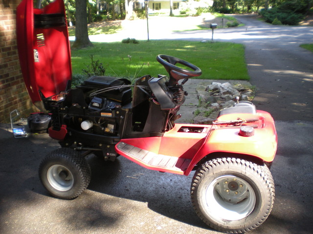

shallowwatersailor 3,222 #3 Posted August 31, 2015 This photo probably doesn't show what you're looking for. It is my 520xi when I first brought it home and you can see the routing of the cables. Just like Don says, both my 518xi and 520xi behave the same as what you describe. My 523Dxi though, with the Daihatsu diesel engine, does have a very positive throttle Share this post Link to post Share on other sites
