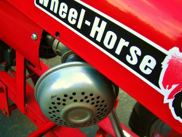

WHX?? 57,933 #41 Posted September 29, 2015 Nice red in your handle John....let's let them pics fly now!!!! I noticed you have the "shower head" muffler on one of them....save it if you can I hear those are like gold! Share this post Link to post Share on other sites
AMC RULES 37,259 #42 Posted September 30, 2015 You're not referring to the muffler on that green engine? Pictured below is a "shower head" muffler. 1 Share this post Link to post Share on other sites

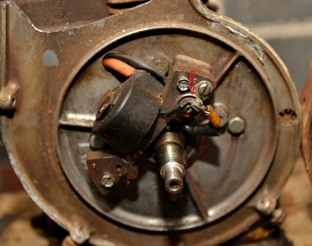

jsp_333 306 #47 Posted September 30, 2015 Thanks, got it last week and printed all 137 pages.Any idea why the first engine pictured has a condenser (?) and the second one doesn't Share this post Link to post Share on other sites
WHX?? 57,933 #48 Posted September 30, 2015 I would guess the condeser is this, just mounted differently unless it is in by the points, I think some of them are there too. Share this post Link to post Share on other sites
jsp_333 306 #49 Posted September 30, 2015 Ya most of the ones I've seen are by the points but boy that looks like a funny place to put a condenser.I also wouldn't think the magnet is deep enough but you never know.I'll try and get into it tonight but time will be tight.Probably just clean and then switch the flywheels and see it I get a better spark.I'm thinking pulling everything off of one and switching it to the other is going to take some time and light Share this post Link to post Share on other sites
jsp_333 306 #50 Posted October 1, 2015 WHX5 was right - pulled it apart last night off sure enough that's where the condenser was - see red arrow in photo above.Today's question; Is the spark plug wire just supposed to pop out of the coil? Pulled two apart last night.Can't see any way to attach it other than just jamming it back in the hole on the coil. There appears to be a spikey thingy at the bottom of the hole but can't see how that would work given the vibrations of a running engine?Thanks to all Share this post Link to post Share on other sites
