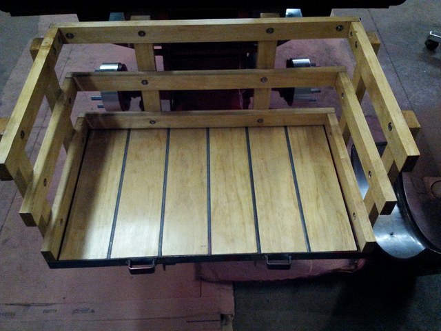

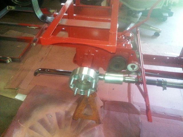

Bud Andrews 237 #76 Posted September 9, 2015 WHX5, could they be used with inner tubes in them? Got the exhaust system finished today while my Honey stained and varnished the woodwork. Miserable hot here again today , had to call it quits for awhile..... 8 Share this post Link to post Share on other sites

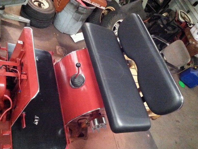

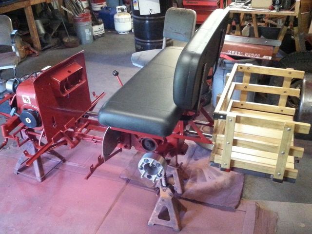

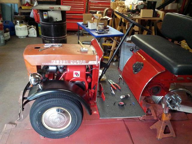

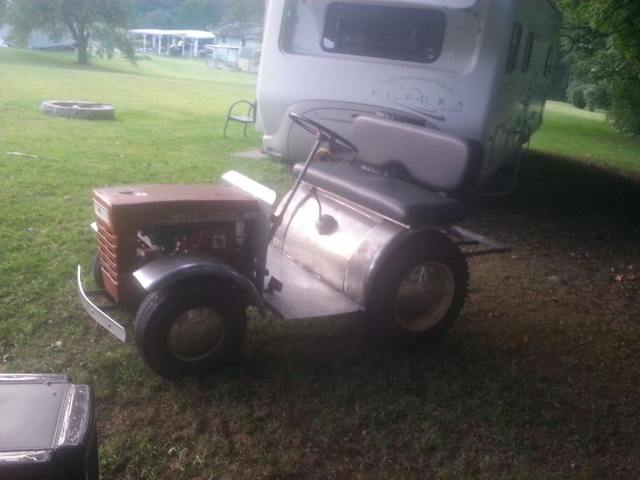

DennisThornton 4,773 #82 Posted September 11, 2015 Dennis, I rolled the sheet metal, an inch at a time by gradually bending it in my Harbor Freight 40 dollar , 30 inch sheet metal brake. The hubs are 5 X 4.5 bolt pattern, 2 inches wide, sold on eBay as Jeep wheel spacers and the seat is just an ordinary EZ GO golf cart seat. Some things I can't make , lol I've seen some of your work! I could reupholster the seat so I know you could! Just that the corners are very well done! That's the tricky part! Share this post Link to post Share on other sites
DennisThornton 4,773 #83 Posted September 11, 2015 You and the folks at wherever you buy the door edge trim must be on a first name basis! 3 Share this post Link to post Share on other sites

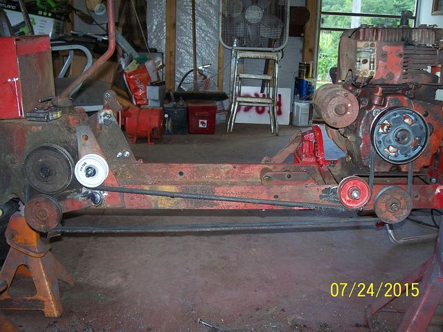

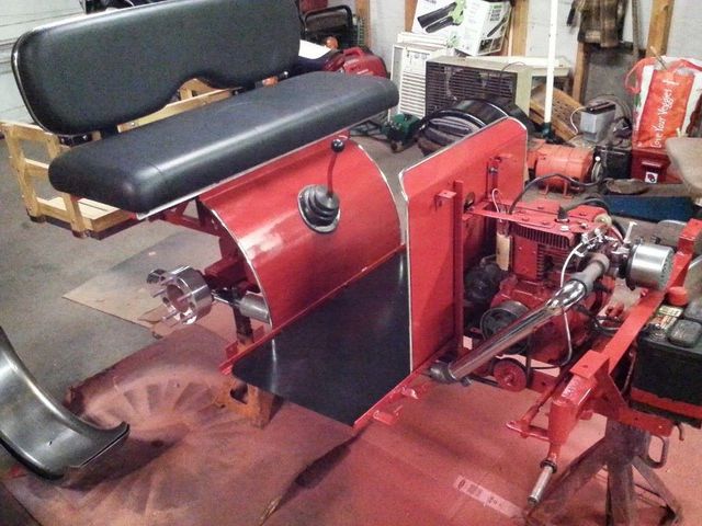

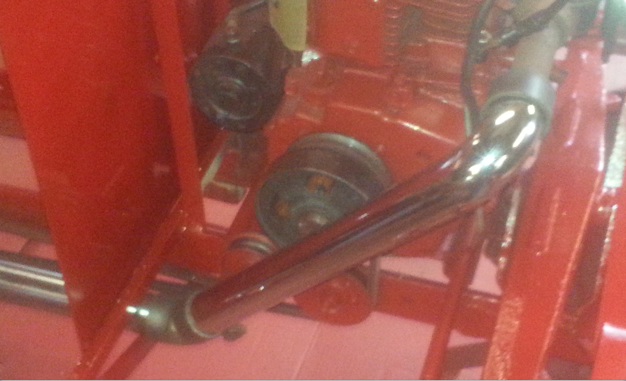

DennisThornton 4,773 #84 Posted September 11, 2015 Bud, you might say a few words about the exhaust system. Curious about the ell. How long does the chrome drain pipe hold up? Esp up by the engine?And you've playing around with the drive belt and pulleys too! Share this post Link to post Share on other sites

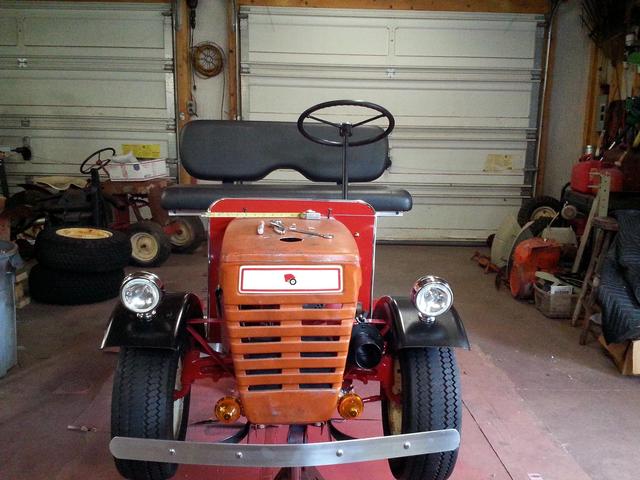

WHX?? 58,347 #85 Posted September 11, 2015 Gotta ask Bud whats that button on the floor board for? A wolf whistle? 1 Share this post Link to post Share on other sites

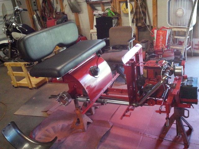

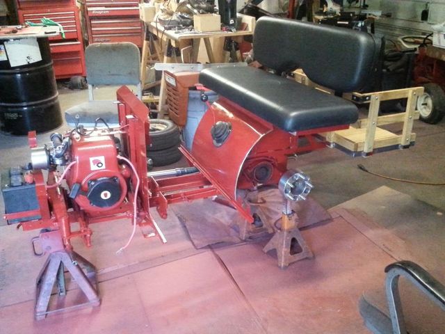

Bud Andrews 237 #86 Posted September 11, 2015 (edited) ooooogah ! lolThe el is a 45 degree 1 inch pipe elbow. I turned both ends in the lathe so the pipe is a nice slip fit. I make my own clamps. The chrome pipe is holding up good, only ever had one turn blue near the engine. The belt is routed under the floor , around 4 idler pulleys. Edited September 11, 2015 by Bud Andrews 1 Share this post Link to post Share on other sites
Pullstart 71,520 #87 Posted September 11, 2015 Is the governor still in tact while using the centrifugal clutch? nice work you're doing there! Share this post Link to post Share on other sites
Bud Andrews 237 #88 Posted September 11, 2015 yes the governor works fine Share this post Link to post Share on other sites
DennisThornton 4,773 #89 Posted September 11, 2015 Thanks for the explanation, Bud! I'm surprised the thin walled chrome drain pipe holds up that well! Sure looks nice! Share this post Link to post Share on other sites
857 horse 2,588 #90 Posted September 12, 2015 BUD...........THAT IS VERY CREATIVE PULLEY SYSTEM....I LIKE IT !!!!! 2 Share this post Link to post Share on other sites

DennisThornton 4,773 #94 Posted September 12, 2015 Man! That is just neater than all get out! If that's not an in-the-parade eye-ball catcher!Rear view mirrors? Bug eyed headlamps? Hood ornament? Neat as it is I'm thinking you might have more ideas still?So no mower deck, snow plow then? Share this post Link to post Share on other sites
WHX?? 58,347 #95 Posted September 12, 2015 That thing has got a heck of a road gear....really hauls the mail! Chrome exhausts getting the blues can mean the motor is running too rich. Share this post Link to post Share on other sites

DennisThornton 4,773 #97 Posted September 12, 2015 Correct Jim! And I'm guessing that Bud's chrome stays bright because his machine's beauty is not just skin deep! Share this post Link to post Share on other sites

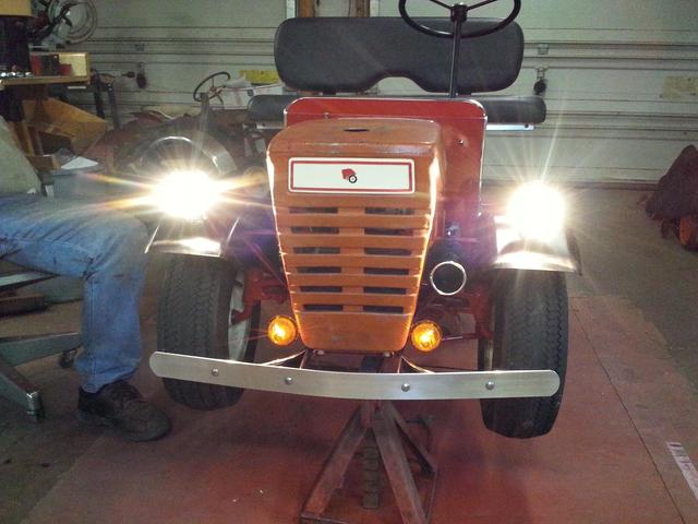

Bud Andrews 237 #100 Posted September 14, 2015 these look about the right size for this..........nice lights for the right money 2 Share this post Link to post Share on other sites
