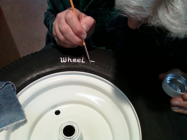

DennisThornton 4,773 #53 Posted September 8, 2015 Bud, I think you and I think a lot a like, just that maybe you think a little better! Yet again! Really nice tractor! These all yours or just some pics you found on the Web? This doesn't have what seems to be your trademark door edge mldg anywhere! But then it is nice and lots of attention to details. Maybe. Could be! Very nice! I've learned something again but I'm not sure what and I hate to ask in front of all these guys. Those front tires OEM? With "Wheel Horse" molded into them? I didn't know WH had their own brand tires! Or you just foolin' with us? You paint that in there on a flat spot? Nice!Save that picture too! Share this post Link to post Share on other sites

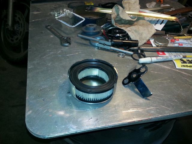

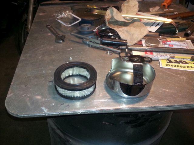

Bud Andrews 237 #54 Posted September 8, 2015 Here's one I couldn't resist, I took a Harley Davidson horn cover and made ( or "re-purposed") this. I lay for stuff like this on eBay and nail it when it when it's only a few bucks. It looks sweet on my K91. Dennis , all these are mine ! My wife's steady hand lettered the tires on the 700, she used a small brush and silver paint. 6 Share this post Link to post Share on other sites

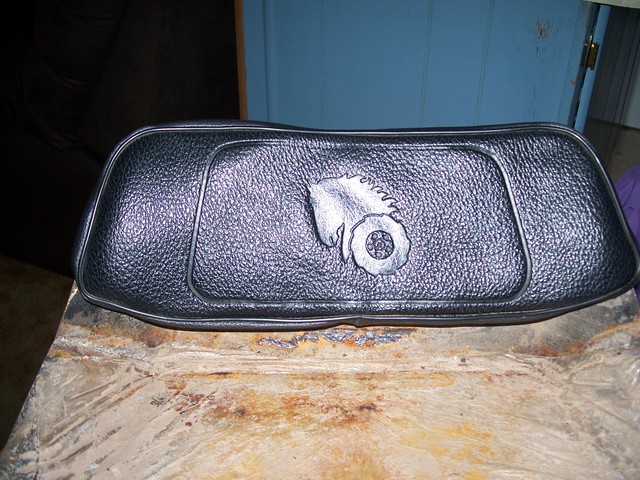

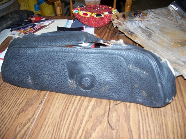

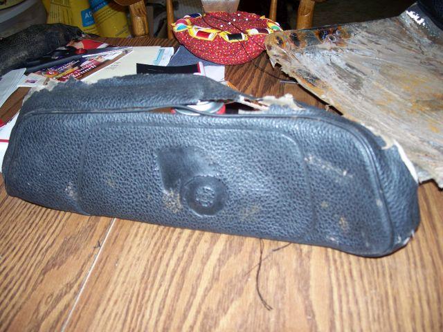

Bud Andrews 237 #55 Posted September 8, 2015 (edited) She sews and cooks good, too ! She restored the seat on the 700, bought and matched up the materials and stitched it back together by hand. She loves our tractors as much as I do ( that's half the battle, lol ). I have given her a couple tractors , the 700 and a 654, which is awaiting restoration, but she uses it around the yard all the time for chores. Oh, and YES Wheel Horse branded their name in many tires. They are the original tires. Edited September 8, 2015 by Bud Andrews 5 Share this post Link to post Share on other sites

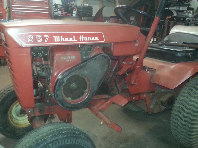

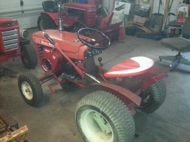

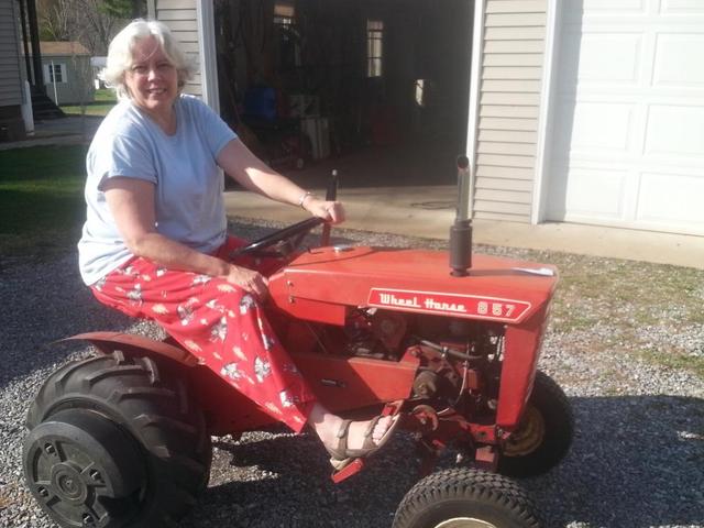

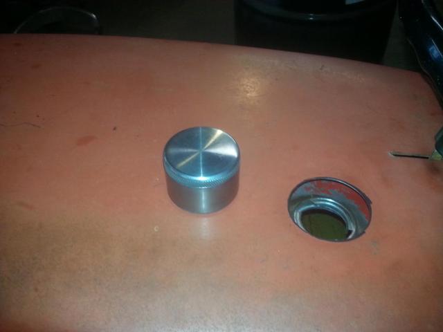

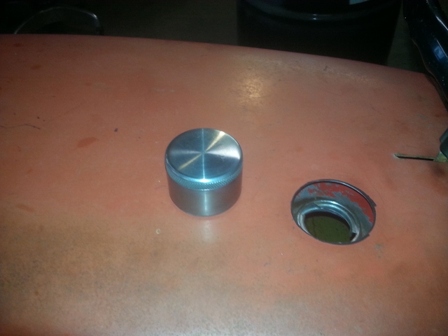

Bud Andrews 237 #63 Posted September 8, 2015 Howard, ( 857 Horse ), Here's one you'll like ! This is my round fender 857. I put the stack up through the hood on this one, and when some one ask "how do you open the hood to put gas in it?" , I decided to put the gas cap up through the hood, too. I can check the oil with the hood down, so it don't have to be raised unless something is really wrong. It is my daily worker , mower, plow tractor. The chrome edge molding looks nice on these generator belt guards. It was a pile of junk when I got it, lots of parts missing. I made the generator belt guard for it from scratch, put a twin stick transmission in it , and then did the round fender conversion. It is one of my favorite machines. 10 Share this post Link to post Share on other sites
DennisThornton 4,773 #64 Posted September 8, 2015 Isn't that something! Share this post Link to post Share on other sites
AMC RULES 37,259 #65 Posted September 8, 2015 Wonder why them square hooded 's...look so good with round hood fenders on 'em. 2 Share this post Link to post Share on other sites

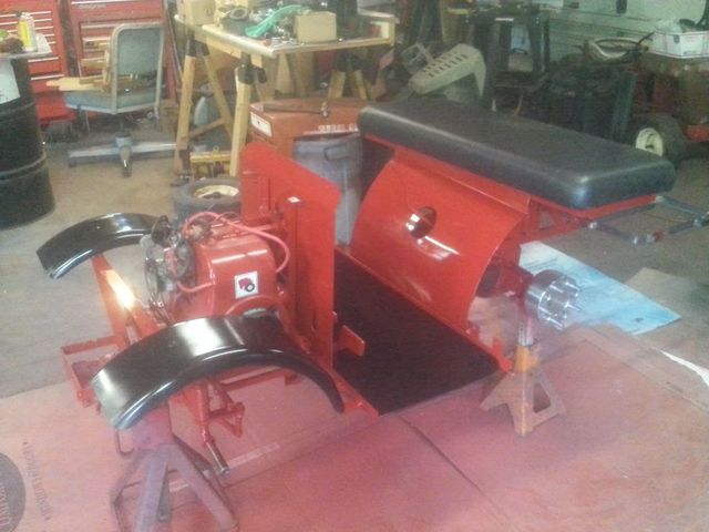

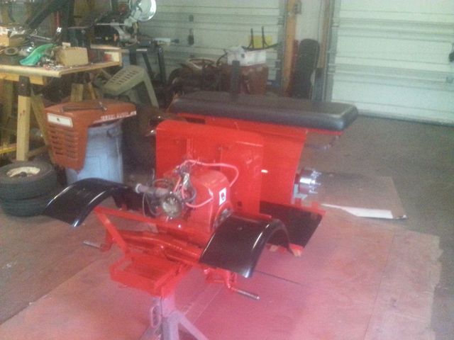

DennisThornton 4,773 #73 Posted September 9, 2015 How did you roll the panel under the seat?You make the extended hubs?Upholster the seat? Nice job on the corners whoever did it! Share this post Link to post Share on other sites
Bud Andrews 237 #74 Posted September 9, 2015 Dennis, I rolled the sheet metal, an inch at a time by gradually bending it in my Harbor Freight 40 dollar , 30 inch sheet metal brake. The hubs are 5 X 4.5 bolt pattern, 2 inches wide, sold on eBay as Jeep wheel spacers and the seat is just an ordinary EZ GO golf cart seat. Some things I can't make , lol 2 Share this post Link to post Share on other sites
WHX?? 57,601 #75 Posted September 9, 2015 (edited) Love the raw look of the recoil on that motor with the HD filter cover Bud, you sure do have a talent I envy!I have a few of those tires with the WH on them. They don't hold air and are somewhat dry rotted but you have inspired me to clean them up, try and paint them and use them for shop decor! Edited September 9, 2015 by WHX5 2 Share this post Link to post Share on other sites
