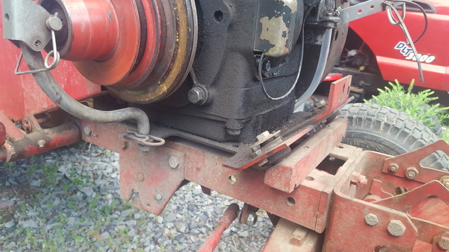

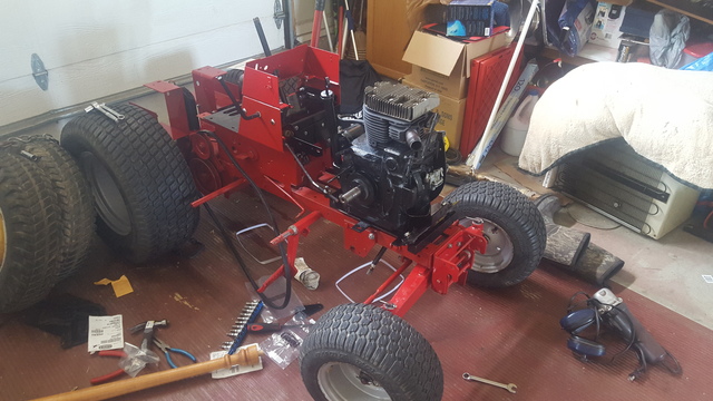

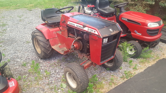

HorseHead1089 100 #56 Posted June 13, 2016 (edited) Well I can't seem to find a place to knock down the diameter of that pto shaft on that Magnum 20, and if I do its gonna cost a lot of money. And with so many toys I can't justify that. So I'm planning on re-assembling and freshening it up before I sell it. So on the local craigslist I saw a C-125 blackhood that looks like it's lived a rougher life than some and decided to scavenge for parts. It has a k301 that appears to be running healthy and could use a freshen up and maintenance, and nice pair of ags tires and all the motor mount and pto stuff. So this motor has a shaker plate and my old k241 didn’t. Obviously the oil pans are different because the k241 had flanges to solid mount it to the frame. Should I get a new pan and solid mount? Install the shaker plate setup? Also the c 125 might be repowered with a spare motor and sold or parted out depending on the condition of the transmission.... Also I don't like the angle of that pepper shaker, any tips on exaust? Edited June 13, 2016 by HorseHead1089 Share this post Link to post Share on other sites

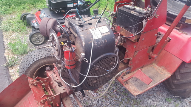

HorseHead1089 100 #57 Posted June 27, 2016 removed the motor and cleaned it up, more pictures will come...anyway to change the title? seems very misleading now Share this post Link to post Share on other sites

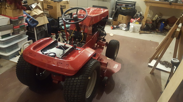

HorseHead1089 100 #66 Posted November 10, 2016 I ended up flipping the M20 for some cash to help make my tractor a bit more functional as far as attachments/pto setup, it is nearly done, i just have to route the exaust out from under the hood, and get a seat on it, i pcked up a 42 inch deck for 150 bucks that had been fully restored 15 years ago maybe? pictures will come i have been SUPER busy Share this post Link to post Share on other sites

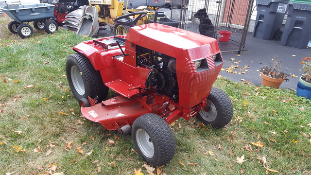

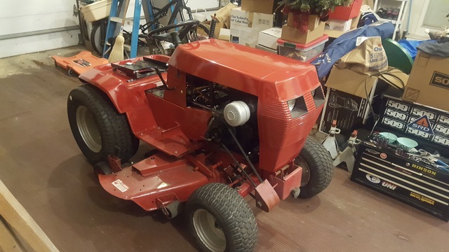

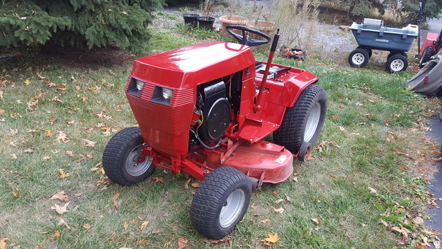

HorseHead1089 100 #67 Posted November 18, 2016 Photo dump, almost done. Runs good and drives good. Although this isn't what it was supposed to be originally, I have bought another horse 40+ years of service! That's Mainly why I like to do these restores! 3 Share this post Link to post Share on other sites
