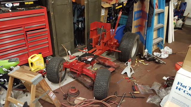

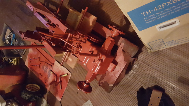

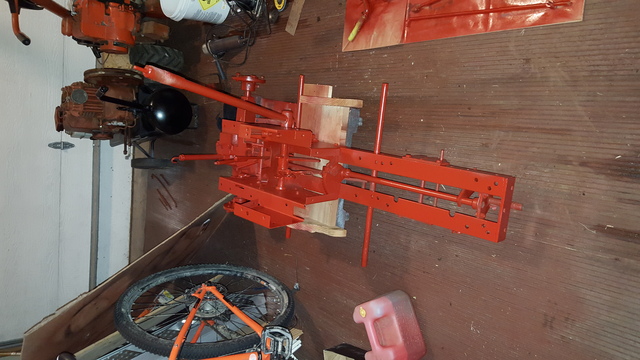

HorseHead1089 100 #26 Posted October 13, 2015 (edited) Well,today I painted the frame and other such, I guess ive finally made it to two pages! Hopefully assembly will take place soon....for the gear drive, the engine pulley is 5.5 inches correct? Because I have to order one for the huge crank on the 20 hp mag. Edited October 13, 2015 by HorseHead1089 1 Share this post Link to post Share on other sites
Ken B 3,203 #27 Posted October 13, 2015 Should be pretty cool when done. But dude, you got no shoes on? 1 Share this post Link to post Share on other sites
HorseHead1089 100 #28 Posted October 13, 2015 (edited) haha, for the shoes part I uassually go take pictures after I'm done working, I don't work without the foot protectors. this whole picture rotation thing bothers me. Maybe one day I will figure out wich way spits them out straight. Edited October 13, 2015 by HorseHead1089 1 Share this post Link to post Share on other sites

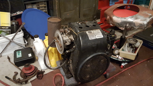

HorseHead1089 100 #40 Posted October 20, 2015 Motor Mount has arrived!!! now onto doctoring up the motor and some other odds and ends while i wait for my stuff to get back from the body shop. now back to the Homework... Share this post Link to post Share on other sites

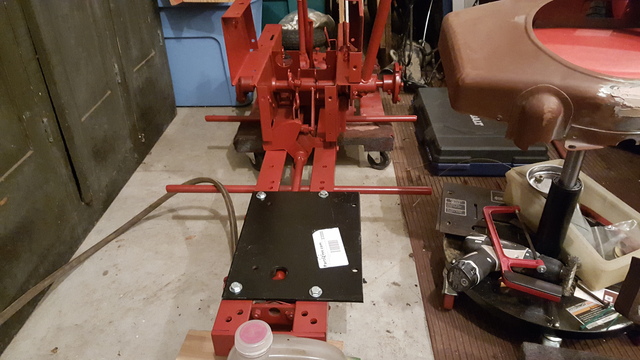

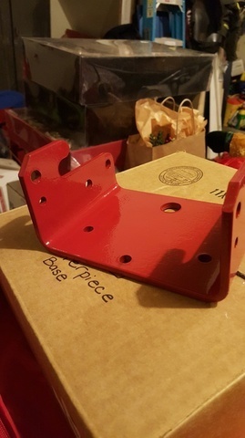

HorseHead1089 100 #41 Posted October 24, 2015 It's been a long week of school, but due to buying parts like a madman I gotta re route time from the 320 to other things like my 10hp K series and some craftsman I picked up for cheap to sell later. Well that's in the shop today so I guess that's the first order of business. I also mounted up the motor plate on the 320, I can already see that 20hp bulging out the side of the narrow hood. Share this post Link to post Share on other sites

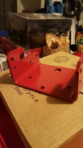

Thor27 892 #44 Posted October 30, 2015 Is that a NEW motor plate? Partstree? Share this post Link to post Share on other sites

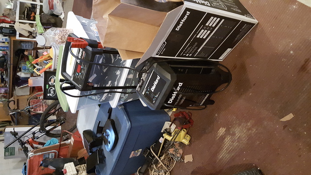

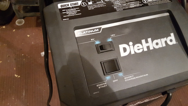

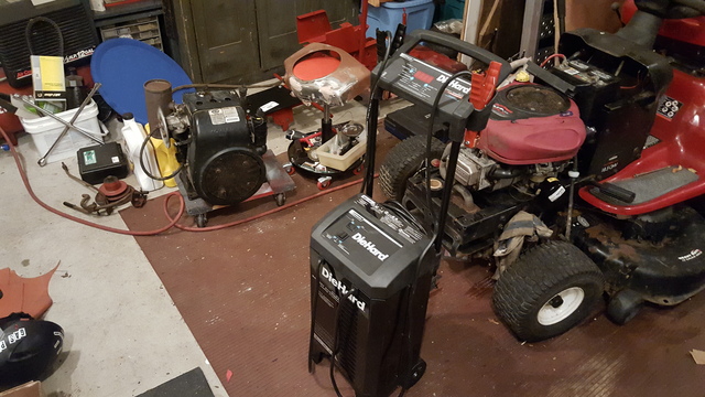

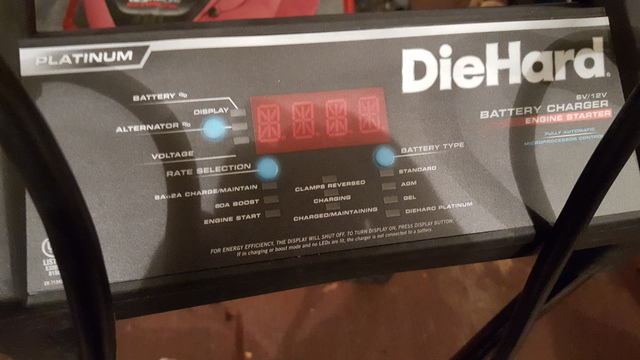

HorseHead1089 100 #45 Posted October 30, 2015 Yes it is, no one felt like selling one on ebay and I didn't feel like making one so I just bought a new one. It's bolted down with brand new Shiney stuff I'll get a picture tonight. Also bought this on sale 6/12v with auto charge rate and float maintainer/trickle charge has wheels and range of options from sears I throw some more pictures up of this as well. Share this post Link to post Share on other sites
HorseHead1089 100 #46 Posted October 31, 2015 Well that's the brand new motor mount, and there are more pics of the new battery charger. Also that 10hp K series is currentley up for grabs if someone feels like making an offer. 1 Share this post Link to post Share on other sites

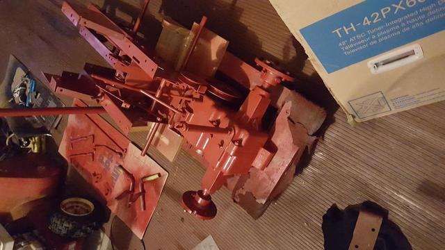

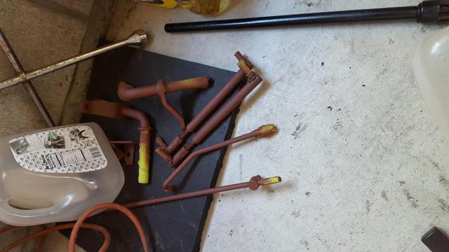

HorseHead1089 100 #50 Posted February 4, 2016 Well 4 pages deep and several months since an update, I bet you guys thought I gave up! Nope, in fact it's been real exciting. That quick flip of a craftsman turned into an engine rebuilding nightmare and that was not fun. I have yet to sell that sorry piece of machinery. On the 320 front, we have the parts sandblasted and painted from the shop done, and now ready to put back together. As far as the motor, no progress has been made on it since I have had barley anytime to work at all! Now I have her resting on all fours and I just need some cotter pins and other hardware. This has been quite an interesting build so far! 4 Share this post Link to post Share on other sites
