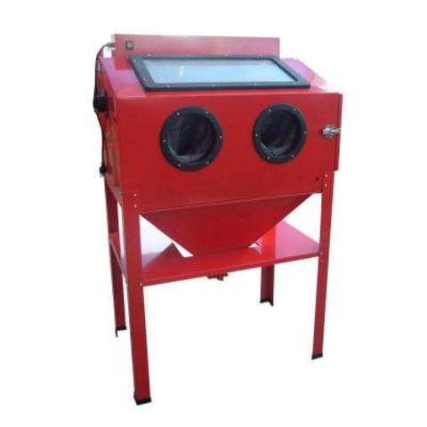

MikesRJ 558 #19 Posted August 26, 2015 (edited) I have one of these HF Sand Blasting cabinets and a rather large compressor to run it. I have "Black Diamond" 12-40 grit (course) in it and have never had any issues blasting anything all the way down to K90 tins. Edited August 26, 2015 by MikesRJ Share this post Link to post Share on other sites

Shynon 7,543 #22 Posted August 26, 2015 I have one of these HF Sand Blasting cabinets and a rather large compressor to run it. I have "Black Diamond" 12-40 grit (course) in it and have never had any issues blasting anything all the way down to K90 tins. I am using the same thing, works great. The only thing that will not fit is a hood, frame and c series seat pan. 2 Share this post Link to post Share on other sites

Aldon 4,832 #24 Posted August 26, 2015 I added a dust buddy cyclonic catcher. Use my shop vac. 50 bucks and works great for filtration and keeping the visibility higher in my HF cabinet. If you use the HF much, your wear out the gloves. I am not keen on reaching into the cabinet to swap the gloves so I reversed the glove collars to the outside and bought slightly longer gloves. Now I can easily swap when necessary. Pics on my GT14 restomod thread. 1 Share this post Link to post Share on other sites
WHX?? 54,995 #25 Posted August 26, 2015 I have a guy in town here that does headstones and he does my blasting for the price of a 12 pack. Trouble is he is hard to catch around so I am thinking about one of those HF ones. I hate to fork out alot on cash for one cause it's gonna be like the parts washer, sits ther most of the time but is there when you need it. Thinking about a smaller benchtop version just for smaller stuff and leave the hoods, rims, frames for my tombstone guy or do i just say the heck with it and pop for a bigger one?Possibly could build my own in my sheet metal shop but by the time its done would be better to spring for a HF one? The little stuff like gloves, nozzles etc would add up.... Share this post Link to post Share on other sites
