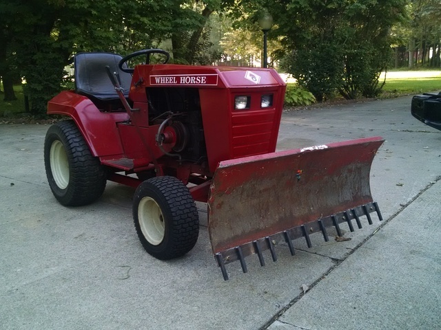

semper5 43 #10 Posted April 23, 2016 I never posted a pic of my finished surface-scratcher, so here it is. Has come in so very handy! 1 Share this post Link to post Share on other sites
c-series don 11,473 #11 Posted April 23, 2016 If you have the lift BAR and not a chain lift it should pick the front wheels off the ground. That down pressure is a must for grading. I must say I like what you have done, good luck! 1 Share this post Link to post Share on other sites
