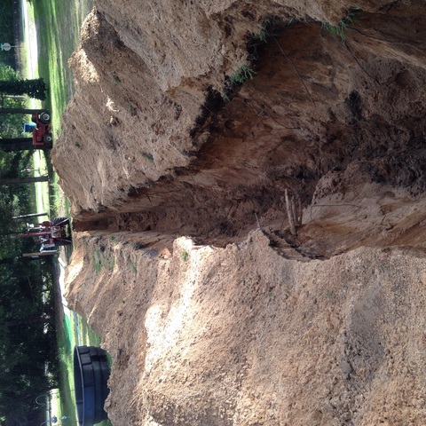

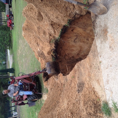

Lane Ranger 11,741 #29 Posted September 14, 2015 How deep will one of those backhoes go in the ground ?? Share this post Link to post Share on other sites
alswagg 128 #30 Posted September 14, 2015 I dug a 90' trench this past weekend 6' deep in most areas The other D's with front dozer blade and mid grader blade did the backfill and leveling. Share this post Link to post Share on other sites

Brrly1 1,146 #35 Posted September 15, 2015 Luv the tractor, but you better dig that hole a bit wider or get some shoring. You'd feel like crap if that hole caved in on your son. Not an expert by any means I've seen alot of cave ins beings that was also part of my job. Share this post Link to post Share on other sites

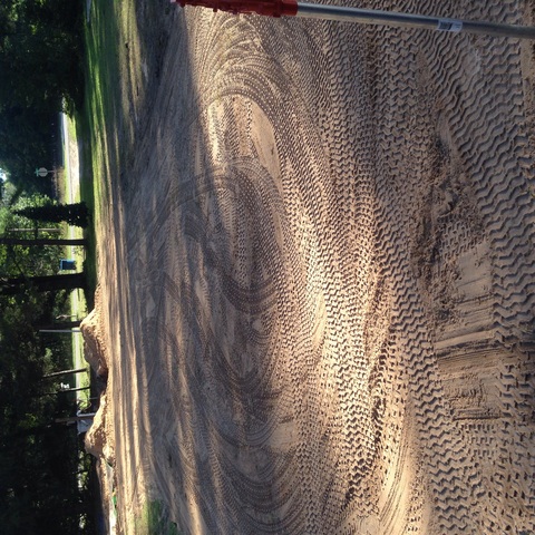

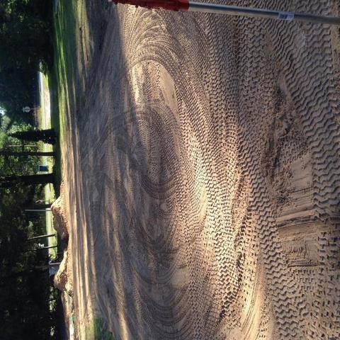

alswagg 128 #36 Posted September 16, 2015 Here is another view of the dig Share this post Link to post Share on other sites
