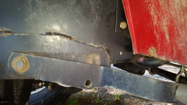

Xearl 132 #1 Posted August 22, 2015 (edited) I was working on my 318xi when I noticed that the lift arm for the mower deck had a hole where it looked like a bolt may belong . I checked the other side and it was the same , no bolt .. I then went and looked at my 523dxi and in the hole there was a pin with a clip ( clevis ? ) in each side . It looks like the pin restricts movement of the arm. Does anybody know anything about this ?? It's always something . I love my Toro . ED Edited August 24, 2015 by Xearl Share this post Link to post Share on other sites
Xearl 132 #2 Posted September 5, 2015 When all is lost look in the manual . When using a snow blower insert a pin ,in the hole ,on either side . it restricts movement of the arm . I now know why the mower deck had so little up and down movement . Share this post Link to post Share on other sites
doc724 925 #3 Posted September 5, 2015 When using anything other than the mower, the pin(s) must be inserted Share this post Link to post Share on other sites
Xearl 132 #4 Posted September 6, 2015 Thank you . I never knew about the pins and never used them with the snow blade . Share this post Link to post Share on other sites
