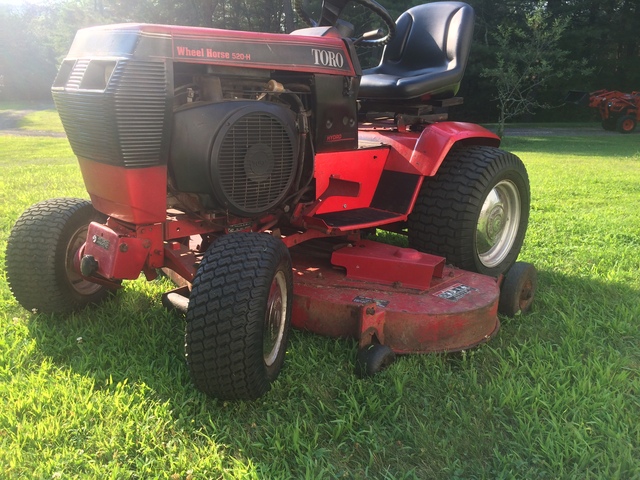

muz123 1,193 #1 Posted August 17, 2015 (edited) I picked up this 60inch deck from Tom [Stratostar250] and a 520 parts frame. Also i am just wondering but how do you get this beast off and on the tractor easily? I had a heckava time getting it on. Any ideas? Only because I'm plowing with this tractor this year. I used my Kioti tractor bucket loader to get the deck on. LOL Its in the background on one of the pictures if you can see it.Thanks, Dave Edited August 17, 2015 by muz123 2 Share this post Link to post Share on other sites

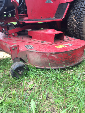

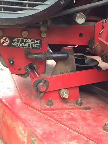

WNYPCRepair 1,924 #12 Posted August 18, 2015 (edited) Here are pictures of mine. I thought I had a picture of the tires hitting, but I guess not. This is the lift bar and attachomatic hitting, with the deck on the ground with wheels lowered. The lift only has to lift it slightly to get it to lock in. I have since lowered the front rollers, and it isn't as bad, but it isn't easy. Edited August 18, 2015 by WNYPCRepair 2 Share this post Link to post Share on other sites

cheesegrader 434 #16 Posted August 18, 2015 Brian,The front wheels on the 60" deck are not original. I have one with them and one without. There is a dealer service bulletin instructing dealers to weld them on from about 1989. I've seen lots of different versions of front wheels, and yours are the TALLEST ones I have ever seen. Mine are more like the fixed height oval rollers on the 48" decks. I'm sure your clearance problems are related to those very tall front wheels. Maybe it would slide under if those wheels were dropped all the way down to the ground?I know that some guys drive over, but I have had trouble with the deck spitting forward when I try to drive on, and I worry about doing something stupid in the process like damaging a front tire or snapping off a zerk fitting. It seemed like a great idea when I first heard it, but it just didn't save me any time or effort when I tried it. 2 Share this post Link to post Share on other sites

cleat 8,743 #20 Posted August 19, 2015 Here are pictures of mine. I thought I had a picture of the tires hitting, but I guess not. This is the lift bar and attachomatic hitting, with the deck on the ground with wheels lowered. The lift only has to lift it slightly to get it to lock in. I have since lowered the front rollers, and it isn't as bad, but it isn't easy. Gauge wheels should be adjusted as they are set to raise the front of the deck too high. They should not be touching the ground if the deck is levelled properly.Also, I think your tach is not latching properly, is bent or worn. The bar on the deck should securely latch into placeOtherwise great deck, I love mine and it mows very well. Makes the tractor work though.Cleat Share this post Link to post Share on other sites
WNYPCRepair 1,924 #21 Posted August 19, 2015 It is partially latched, so I could get the deck under that far. With it unlatched, it won't go under at all. Share this post Link to post Share on other sites

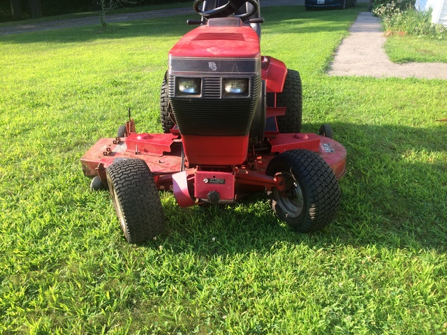

muz123 1,193 #22 Posted August 19, 2015 So should i level my deck or does it look ok? Share this post Link to post Share on other sites
cheesegrader 434 #23 Posted August 20, 2015 Muz,Your deck looks OK, but it is hard to tell in pictures. The only way to know is to check with a level, and adjust the trunion at the back center of the shell.The front anti-scalp wheels look like they are set really low. I would raise them so they just barely hit the ground before the front of the shell scrapes.They aren't supposed to touch the ground at all if everything is adjusted right Share this post Link to post Share on other sites
