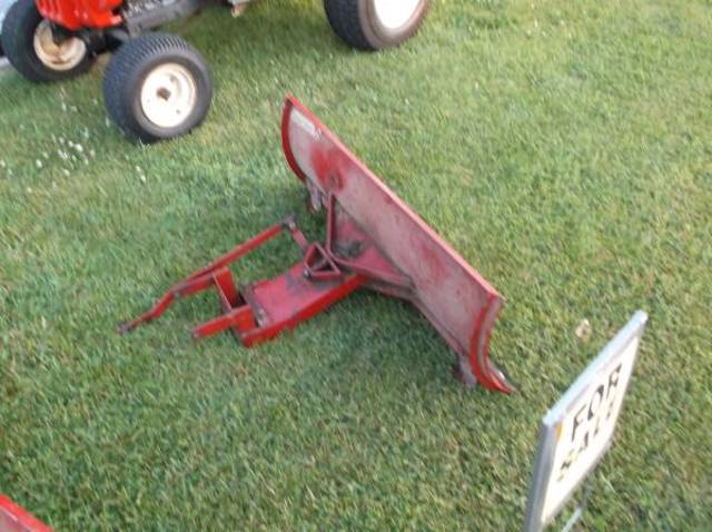

jeremi3210 742 #1 Posted August 14, 2015 Does anybody know if this is a suburban snow blade? If not what will it fit? Thanks in advance. 2 Share this post Link to post Share on other sites
wallfish 18,195 #2 Posted August 14, 2015 Yes it is Ask if they have the foot pedal to go with it. It connects with a small chain and is used to release the pin which holds the blade in position. Not completely necessary to have but it's nice for setting the angle from the seat. A small rope connected to the top corners of the blade and draped over the steering wheel is used to pull the blade into different positions.Look on the tractor if they have it It'll fit 400,550, 401, 551 and an RJ but will need the RJ adapter mount to clear the front axle 2 Share this post Link to post Share on other sites
jeremi3210 742 #3 Posted August 14, 2015 Ok the guy selling it wants 125.00. It doesn't have the foot pedal with it. Iam not up on what these things are going for, does that sound like a fair price? Share this post Link to post Share on other sites

KC9KAS 4,744 #5 Posted August 14, 2015 I would say that is a fair price. Probably rare to find one like this. 2 Share this post Link to post Share on other sites

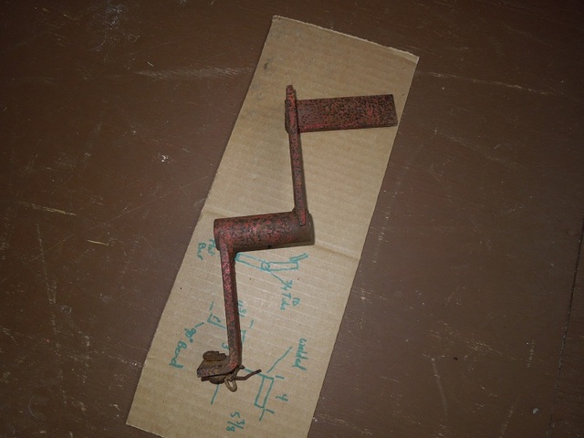

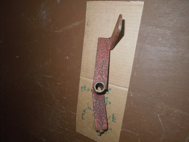

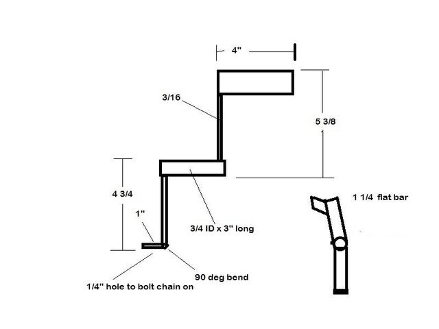

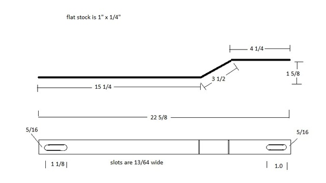

wallfish 18,195 #7 Posted August 16, 2015 Here's what the pedal looks like if you want make one or look for an original 4 Share this post Link to post Share on other sites
CasualObserver 3,411 #8 Posted August 17, 2015 @wallfish Nice pics and drawing John, that will help a lot of people. I just had that pedal in my hand this weekend and was thinking of doing the same thing. (stuff like this is something we should build a library of!) 2 Share this post Link to post Share on other sites

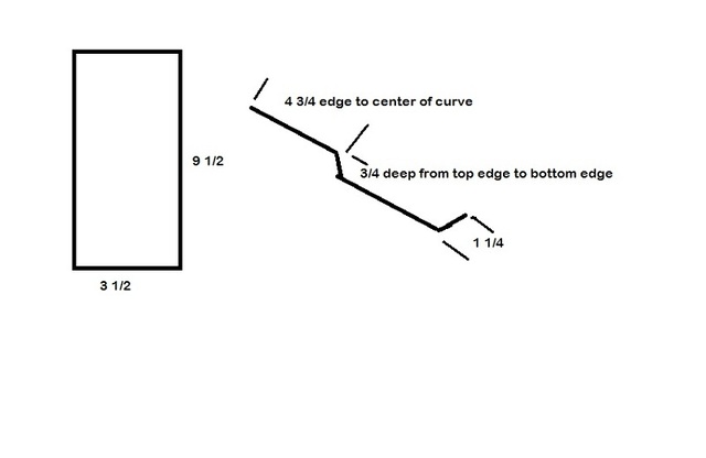

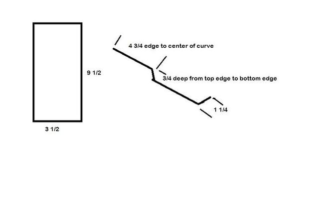

wallfish 18,195 #9 Posted August 17, 2015 (edited) Thanks Jason!So you like my MS Paint handy work of crude drawings huh? Here's another one of the lift link for that blade .I think a library of this stuff is an excellent idea. Small things like these are easier to make than finding one. Stuff like solid lift links for a snow/dozer blade is another thing many people look for. For making 400 style foot rests Edited August 17, 2015 by wallfish 1 Share this post Link to post Share on other sites
