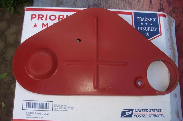

:laughing-rofl: I can't tell you the number of times I've jumped out of my chair to run out and look at something because of something I read here.
The 61's had the cross and the 60's were just a single ridge. Edited by Racinbob
switched the 60 and 61
  • Like 2
RedRanger
:laughing-rofl:
The 60 had the cross and the 61's were just a single ridge.
I think that's backwards.
  • Like 2
Racinbob
That's possible. I'm just going by what the guy who has the repos said because he had both. :confusion-shrug:
Do a search and it's pretty much a 50/50 thing. There's really no way to be absolutely certain unless you were there when the tractor was uncrated. Oh wait....that was 55 years ago.....but I don't remember :D
Edited by Racinbob
  • Like 1
AMC RULES

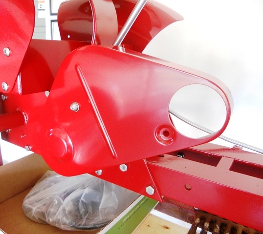

difference was the 1960 version only had the vertical line rolled into it...didn't include horizontal...was the same overall shape though.
  • Like 2
cdsl810
I found a reproduction 1960 cover with just one stiffener line, not the cross. Thanks for the descriptions and picture.

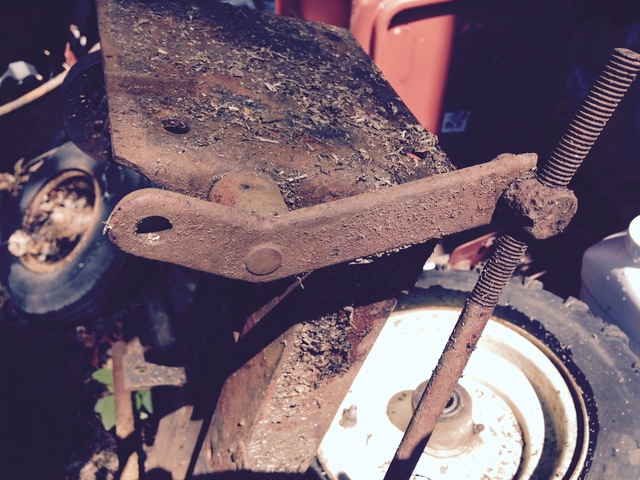

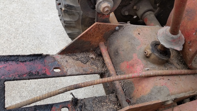

Here's what the critical part for the idler pulley looks like.It connects the pedal linkage and the brake band. The 400 didn't use an adjustable rod to connect the pedal but it's a good idea to use one. You will constantly see 400 tractors with the pedal so far back towards the trans, it's a pain to engage it.
This one is going to be rusted on the shaft tight and the roll pin is going to be stuck. I find it easier to just cut the shaft to get off and weld it back together
1_clutch_part.thumb.jpg.ced3ea7f2184e519
I have located THIS part shown along with the rod. I have also located a rod that is just long enough to fit through the frame and has one arm with a hole at the end...it just so happens to slip right over the part you picture here.

The belt guard should have more of a pork chop shape..... will try and post a pic...... RJ guards are close but no cigar....

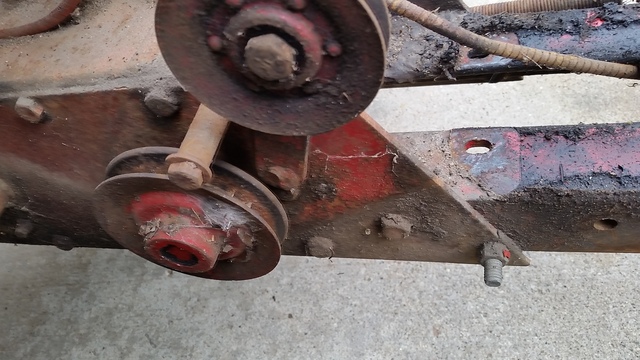

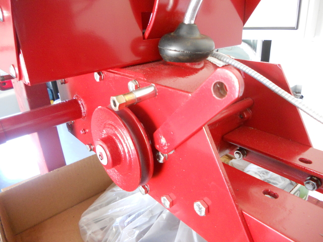

idler/clutch setup should look somethin like this...
Less all the gunk of course!!:o
The bolt you see with the spacer between the idler and input sheave is wht holds the guard on. Ther should also be one on the engine.
So from this, I can see that the angled arm attaches to the brake band and clutch rod, and the straight arm to the idler pulley. Looks like I just need to find a pulley and its mounting hardware for the end of the arm.

You might be able to find a generic one at a TSC or just about any mower place or online. It won't be original but nobobody will notice it under the belt guard I don't know the diameter but ‌Racinbob can jump out of his chair and measure it! I think the bearing has a 5/16" bore. The one you see pictured there is going to get replaced as the bearing is shot. I plan on grinding those rivets out  and looking for a bearing then either rivet or bolt it back together. I have done this to lots of deck pulleys that are NLA. Some of these Toro belt tensioners are outrageous in price and this is more resonable.

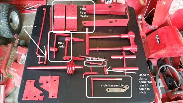

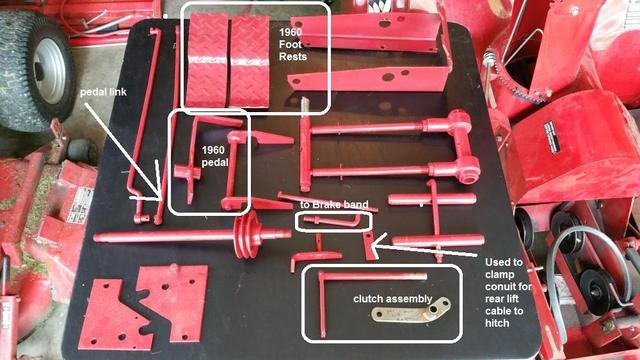

Time to play "what's on the table." I still haven't ID'd all of this. Here's what I think so far.
Starting top left... one of these rods is the clutch rod, don't know about the other. The foot rests are obvious. Next to the rods is the (backwards) clutch pedal. The shaft/double pulley is for the mower deck PTO. The small "J" rod connects to the brake band. Below that I think is the parking brake lever. Bottom right are the two sides of the idler pulley/clutch/brake band rig. The other stuff I'm not sure of yet. These parts may belong to attachments.
  • Like 1
Racinbob
I head to the garage with tape measure in hand..........3". I can't get to the stud right now but I believe it's larger than 5/16". There's additional parts as you can see on the diagram. The hole in the idler arm will determine that. The pulley stands off the arm about 1/2" but, of course, the important thing is that it lines up with the input pulley. Give me the word and I'd be happy to get some detailed pictures in the morning. The straight rod is the clutch rod. It should be 20 1/2" center to center on the trunions.
WHX??
Definitly belong to other stuff ... I see some attacha matic parts ther? Correct me if I am wrong guys but I don't think 400's had a parking brake? Looks like you have all the makings for the clutch/brake setup 'cept for the tension pully. Maybe some of the other guys have better pics than my crusty stuff! Stud might be 3/8" Bob....I'm at work & can't run out to the garage! Looks like your missing some collars for the clutch pedal as well.
Edited by WHX4
wallfish
The other stuff is not for your 400 tractor
1table.thumb.jpg.1397a57fd4c373f0e0a03da
  • Like 4
Racinbob
Cool was to show it John. You're right on the no parking brake Jim. You've got some pieces there for a little later tractor deck. The two flat plates and the bracket to the right of the pedal are an early tach-a-matic and the gizmo right and center as well as the pieces just below it are for a late60's mower deck. The little piece just below the brake band rod is the catch for the foot PTO, again, a bit later in the 60's.
  • Like 2
cdsl810
OK. That would explain why I couldn't figure out how they went on the 400. The parking brake catch is something I just saw on a 657 or 1057, can't remember which. Wasn't sure if it went with the 400, but knew what it was supposed to be.
  • Like 1

Well. I have acquired another 1960 Suburban 400 hood so that I can make one good complete hood that is historically accurate. It has the gas tank straps welded in nicely already. So, just some metal work and paint and that should be checked off the list. Also, I have a reproduction 1960 belt cover on its way--should be here Monday or Tuesday. It is made of the same gauge steel, so just some paint and nobody will be able to tell that it's not original. I found a bag of hardware containing the stop collars for each location, and a couple pins.

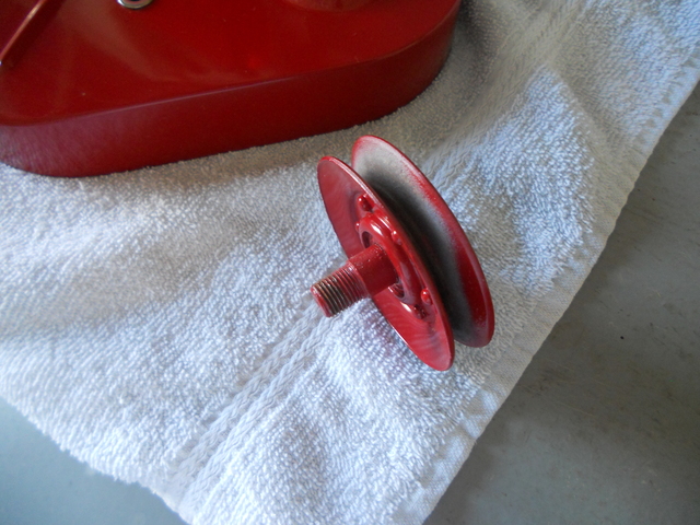

That just leaves that idler pulley and its hardware to mount it on the clutch assembly. 3" diameter, 3/8" stud, 1/2" belt channel... is this what I am looking for?
  • Like 1
Racinbob
It's a 1/2" stud. It's possible that mine was modified prior to me getting it but this is what I have. You could go with something different as long as it is secure on the arm.
Also, I stand corrected and will blame it on old age. I mentioned the cross was on the 60's and I got that because the supplier had both and said the cross was the 60. Well, I should have jumped out of my chair again and looked rather than relying on my memory :doh:

Looked at my belt guard and it doesn't have ANY stiffeners but mine is a very eary "60's. Those repro belt guards are nice! On the idler mount it is a shoulder bolt as Bob shows
