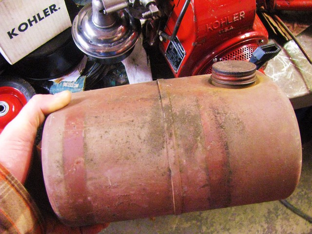

cdsl810 181 #51 Posted August 17, 2015 What is the gas tank supposed to look like on the 400? Share this post Link to post Share on other sites
cdsl810 181 #53 Posted August 17, 2015 OK. This is what I have. What do you think it came from? Can I use it without any problems? Share this post Link to post Share on other sites
AMC RULES 37,259 #54 Posted August 17, 2015 In post #36 here, you mentioned you rec'd another 8hp Kohler in the deal...What I'm assuming is, you're holding the the tank for that engine. Share this post Link to post Share on other sites
cdsl810 181 #55 Posted August 17, 2015 Well, as long as the tank fits under the hood, I guess for now that's what I have to work with.I do not have the strainer to mount below the tank, so I'm assuming it will be OK to install a pipe nipple on the tank and regular fuel hose with an inline fuel filter. The strainer doesn't have anything to do with fuel pressure, does it? It looks like the fuel delivery was just gravity feed. Once again, I'm not the expert yet on anything round hood.I'm still trying to catalog all the parts in the two boxes I was given. I don't yet know what I don't have to get this Suburban moving. It looks like once I figure out the idler pulley and fuel system it can be driven. 1 Share this post Link to post Share on other sites
wallfish 20,576 #56 Posted August 17, 2015 (edited) Nobody will know if you don't have a correct tank unless they kneel down to look under there. No big deal unless you are trying to go factory correct.No need for the glass bowl strainer, fuel filter will work just fine. You can still buy those glass bowl strainers new for under $10 if you want one.http://www.psep.biz/store/small_engine_fuel_filters.htm Found the instruction/parts manual for the blower if you need it Snowthrower_30in_1962_ST-302_ST-3072.pdf Edited August 17, 2015 by wallfish 1 Share this post Link to post Share on other sites
Racinbob 13,143 #57 Posted August 17, 2015 The only issue might be the straps. But that should be easy to solve with careful rebending and using longer bolts under the tank to tie the straps together. Share this post Link to post Share on other sites
CasualObserver 3,416 #58 Posted August 17, 2015 (edited) I'm thinking that 8HP tank is taller and will make the outlet lower than the carb... not ideal on a gravity fed setup. I could be mistaken though. Edited August 17, 2015 by CasualObserver Share this post Link to post Share on other sites
Racinbob 13,143 #59 Posted August 17, 2015 Oh yea, good point. The original tank is 5" for you top compare. You mentioned that the PO was still digging stuff out. Maybe contact him and see if he's got the original. 1 Share this post Link to post Share on other sites
WHX?? 58,083 #60 Posted August 17, 2015 (edited) Hopefully he does and its not full of rust! The larger tank might be able to be used if the outlet is below the carb and the tank is kept more towards full. Correct me if I'm wrong guys but a problem might be the weight of the full tank on the hood. Personnaly I like the OEM sediment bowls - gives it that "big" tractor look and they have a shut off if leaks spring up. I believe my Sub tank has an 1/8" npt female thread on it and it has a a close !/8" nipple to connect tank to bowl. Edited August 17, 2015 by WHX4 1 Share this post Link to post Share on other sites
Racinbob 13,143 #61 Posted August 17, 2015 Yes, the weight can be a problem. It's a good idea not to trailer it with a full tank. The straps break the spot welds. I agree about liking the sediment bowls. That's why I bought one for my Suburban. 1 Share this post Link to post Share on other sites

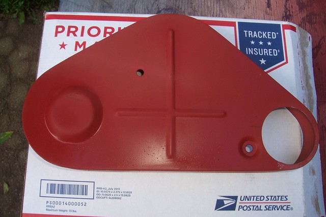

cdsl810 181 #68 Posted August 18, 2015 (edited) What is the belt cover supposed to look like? Mine is not correct--it's only got room for the engine pulley and the drive pulley. That's probably why the PO has a belt attaching just those 2 pulleys. I'm not sure how he expected to shift.Or is this an additional cover for attachment belts? Edited August 18, 2015 by cdsl810 Share this post Link to post Share on other sites
AMC RULES 37,259 #69 Posted August 18, 2015 Appears to be an RJ belt cover there... 1 Share this post Link to post Share on other sites
squonk 48,091 #70 Posted August 18, 2015 Sediment bowls look cool but they leak all the time. I run a nipple and a shutoff then a filter. 2 Share this post Link to post Share on other sites
WHX?? 58,083 #71 Posted August 18, 2015 I like the idea of felt on the straps and even the top of the tank to prevent abrasion. If you are going to use that tank and the outlet is below the carb inlet I would just use maybe a 1/8" street ell on the outlet with filter & fuel cock if desired.The belt guard should have more of a pork chop shape..... will try and post a pic...... RJ guards are close but no cigar....idler/clutch setup should look somethin like this... Less all the gunk of course!! The bolt you see with the spacer between the idler and input sheave is wht holds the guard on. Ther should also be one on the engine. 2 Share this post Link to post Share on other sites
WHX?? 58,083 #72 Posted August 18, 2015 @casualobserver told me that the early Suburban belt guards are unique and sadly rare to find, sorry no pic of it here maybe one of the other guys has one. Should really have one.... 'specially if little ones are going to ride it. Share this post Link to post Share on other sites
Racinbob 13,143 #73 Posted August 18, 2015 Here's the Suburban belt guard. This one is a reproduction. 1 Share this post Link to post Share on other sites
Racinbob 13,143 #74 Posted August 18, 2015 (edited) It's my understanding that the very early Suburban guards the triangle wasn't quite as pronounced. Somewhere between the RJ guards and mine. The later 60's and 61's were as pictured. Edited August 18, 2015 by Racinbob Share this post Link to post Share on other sites
WHX?? 58,083 #75 Posted August 18, 2015 i don't think mine has the stiffener cross...now yer gonna make me run home and look Bob! Share this post Link to post Share on other sites
