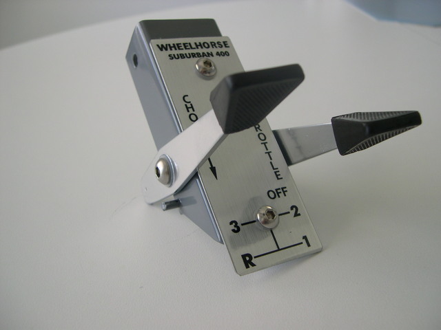

Racinbob 13,143 #29 Posted August 14, 2015 Here's another control plate decal by Terry. The serial # was completely gone and I didn't want a random one.. I flipped the original plate over to get rid of the pitting, made new levers from 3/4" stock from Lowes, and new levers from Glen Pettit. You've got the heat shield and belt guard. Any other that you might need won't break the bank. 4 Share this post Link to post Share on other sites
WHX?? 58,083 #30 Posted August 14, 2015 Sweet Bob .. love the allen hardware! I saw that on another of your posts... Wish I could clean my levers up like that but tryin to stay orginal. We are gonna have to start our own Suburban club complete with secret handshake! 1 Share this post Link to post Share on other sites
Racinbob 13,143 #31 Posted August 14, 2015 Actually, those didn't clean up Jim. I was missing one lever but was able to straighten out the one I had good enough to use it as a pattern. I made a jig to hold the three pieces and went at it with a benchtop belt and disc sander. Basically letting cdsi810 not to worry about some of the missing items. 2 Share this post Link to post Share on other sites

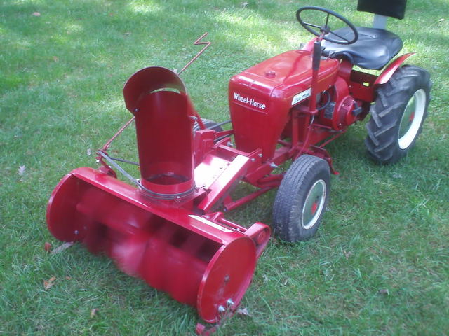

wallfish 20,576 #42 Posted August 15, 2015 Nice to get the extras to go with it. That definitely made the deal sweater.Just some observations on CORRECT parts for your information, not bashing what you have.I never had a 1960 deck so I can't tell what's missing but that does appear to be one. I just know they connected to the rear hitch as part of the lift mechanism. That will certainly mount on there the way it is though.The gas tank is not for an RJ or a suburbanNot too sure about that blower. The blower I have for a suburban has round sides and is 32" wide. Model ST302 which is a 1962 made to fit earlier models. Those little 4 hp engines probably can't handle it anyway. Never actually threw any snow with it but always wanted to give it a try.That wire foot pedal on the deck can be used for the snow/dozer blade to pull the index pin so it can be angled from the seat using a rope.They didn't build an 8hp tractor in 61 so that engine must be another year, if it runs, that's a $150 - $200 value right there 1 Share this post Link to post Share on other sites

cdsl810 181 #44 Posted August 16, 2015 The blower has a designation of ST-302, 30" Snowthrower, July 1960, Serial Number 31078. That's what the documentation I have shows, and the Serial Number on the blower itself matches. It definitely measures 30" across too. If it's not the original one then that's OK. It looks like it hooks right up to the Suburban though. The mower deck does have the rear lift attach on the left side of the deck. Everything on the deck and the blower spin freely, and despite their patina, I could probably lubricate, attach and use them. There are no missing parts as far as my limited eye can tell--except belts.The tractor is missing a couple things, however. If the gas tank is the wrong one, then I should try to find the right one. That is the tank the PO removed when he began the project, and was not purchased later by him. The gas tank mounting straps were unusable he said, and I don't have any--he threw them out. And I can't find the idler pulley setup anywhere. There is, however, a double pulley with a long shaft in the box. I was thinking that it has something to do with powering attachments. I'm going to need help identifying some of the parts in the boxes, but I have matched up several of them to the parts diagrams already. 1 Share this post Link to post Share on other sites
wallfish 20,576 #45 Posted August 16, 2015 (edited) The Blower has a tag ST302 on it? Or that's just what the PO wrote down?I thought the ST302 looks like this, which is completely different. Might have a manual around here somewhere. And you're right, it should be 30" wide not 32 like I posted before.Post up what you are missing, I'll look around for an idler pulley setup.Tank straps would be unusable with that tank but it's pretty common for them to break off at the spot welds on the hood anyway. You can find that stuff on that auction site. Edited August 16, 2015 by wallfish 2 Share this post Link to post Share on other sites
cdsl810 181 #46 Posted August 16, 2015 It looks like I have an ST323 Snowthrower. The PO gave me the wrong one. I found a serial number list in my giant stack of files he gave me. 31078 fits the production numbers for the ST323. He listed the wrong one in his seller's notes to whomever ended up buying the tractor. I asked him about it this evening. He said the same thing... "you're supposed to have the round one." He doesn't have the other tractor, so maybe I can talk him in to giving me both blowers. The ST323 fits the Suburban, however... just wasn't an official attachment for it--it came after they stopped producing the Suburbans. The tractor it belonged to he said was a 604, if I'm remembering correctly. 1 Share this post Link to post Share on other sites
wallfish 20,576 #47 Posted August 16, 2015 (edited) ST323 may bolt onto a suburban but will need a homemade lift tube to raise it because the lift mechanisms on the tractors are completely different. The engines are in different places but not sure if just using a longer belt would hit the front axle or not. The ST302 was also made after production of the suburban tractors in 1962 but made to fit them with just a special lift rod and mount bracket plus a longer belt. The ST3072 is the same exact blower but made with parts for the 1962sIf he does have the 302 blower and you go to get it, look for the mounting bracket. They always seem to end lost because they were left mounted on the tractors. You can see it in the pic. It raises the blower's pivot point above the frame rails to match the height of the 62 tractor frames. The lift rod looks like 2 flags welded to a tube and you can see part of that in the pic too.They used a foot pedal to engage the belt similar to that wire foot pedal you have but made with bent flat bar. Edited August 16, 2015 by wallfish 1 Share this post Link to post Share on other sites
AMC RULES 37,259 #48 Posted August 16, 2015 For reference... here's another ST-302 blower. 2 1 Share this post Link to post Share on other sites

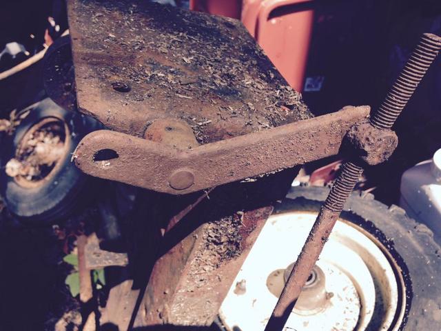

wallfish 20,576 #49 Posted August 16, 2015 Here's what the critical part for the idler pulley looks like.It connects the pedal linkage and the brake band. The 400 didn't use an adjustable rod to connect the pedal but it's a good idea to use one. You will constantly see 400 tractors with the pedal so far back towards the trans, it's a pain to engage it.This one is going to be rusted on the shaft tight and the roll pin is going to be stuck. I find it easier to just cut the shaft to get off and weld it back together 2 Share this post Link to post Share on other sites
gwest_ca-(File Mod) 12,485 #50 Posted August 16, 2015 (edited) 31078 is a 1961 serial number.Have seen 1961 serials range from 2294 to 60695.1960-61 model ST-30 for the mid-engine models1961 model ST-307 for the 701 tractorIn 1962 the attachments got a A-xxxxx serial number.In 1962 the tractors got a 62-xxxxxx serial number.Garry Edited August 16, 2015 by gwest_ca 1 Share this post Link to post Share on other sites
