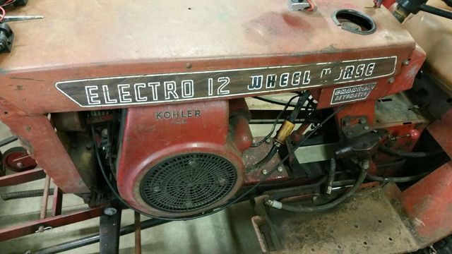

I have a c120 and looking for snow blower for it. Found a guy with one.off of an electro 12. Will it work? Only picture I have at the moment is tractor it is off of.
slammer302
i just ask this question a week or so ago and was told it will fit but the the way it mounts is different since it does not use the attachOmatic  you may need a different size belt to
I just noticed in the picture some one cut a hole on the hood so they don't have to open it to put gas in it. crazy:blink:

You can see the snowthrower mounted on the front of the Electro 12. The plated bolt and washer above the axle is the mounting point. The lift tube is below the axle.
