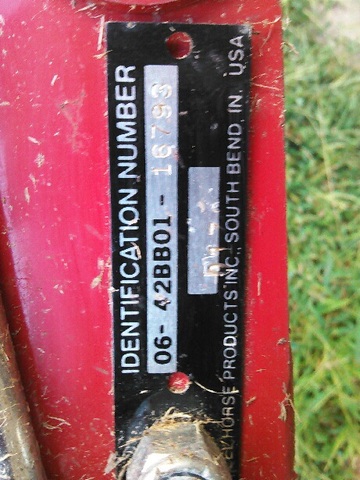

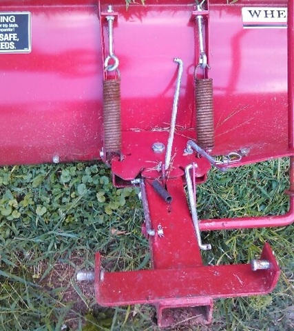

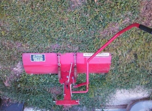

Jay1775 11 #1 Posted August 11, 2015 (edited) I think i found the correct blade for a 211A but i want your guys input as well. Please see the pics below and let me know if this is missing anything?thanks Edited August 11, 2015 by Jay1775 Share this post Link to post Share on other sites
gwest_ca-(File Mod) 12,511 #2 Posted August 12, 2015 (edited) Here Is the blade you tractor calls forhttp://www.wheelhorseforum.com/files/file/2477-blade-dozer-42in-1983-1986-06-42bb02-snow-om-tiplpdf/Here is the one you are looking athttp://www.wheelhorseforum.com/files/file/2867-blade-dozer-42in-1980-1982-06-42bb01-snow-tipl-snpdf/I'm thinking you can make it work but compare the ipl's to see what the difference is.The bottom line on the ID plate looks like 017x. That is the Julian build date 17x day of 1980 if I am reading it correctly make it a 1980 model.16793 is the serial number.Garry Edited August 12, 2015 by gwest_ca Share this post Link to post Share on other sites

gwest_ca-(File Mod) 12,511 #4 Posted August 12, 2015 (edited) I would compare the differences. It may only be a different bearing or pulley size and be nothing to hinder the installation or performance. They were constantly making subtle changes to improve performance.A new safety decal would generate a new model number.Garry Edited August 12, 2015 by gwest_ca Share this post Link to post Share on other sites
