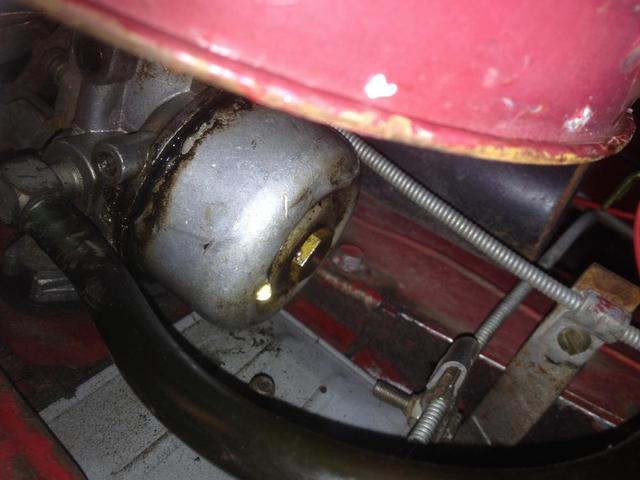

82Caddy 851 #28 Posted August 18, 2015 Discovered there are more then a few leaks in this rear end... Took the pressure washer to it and got it the transmission all cleaned up. Hopefully that'll help me track down where it's leaking from. Found another leak tonight as well. Seems as though the float bowl is leaking. I'll just add it to the list of things to order once I figure out where/why the rear end is leaking from. Share this post Link to post Share on other sites
