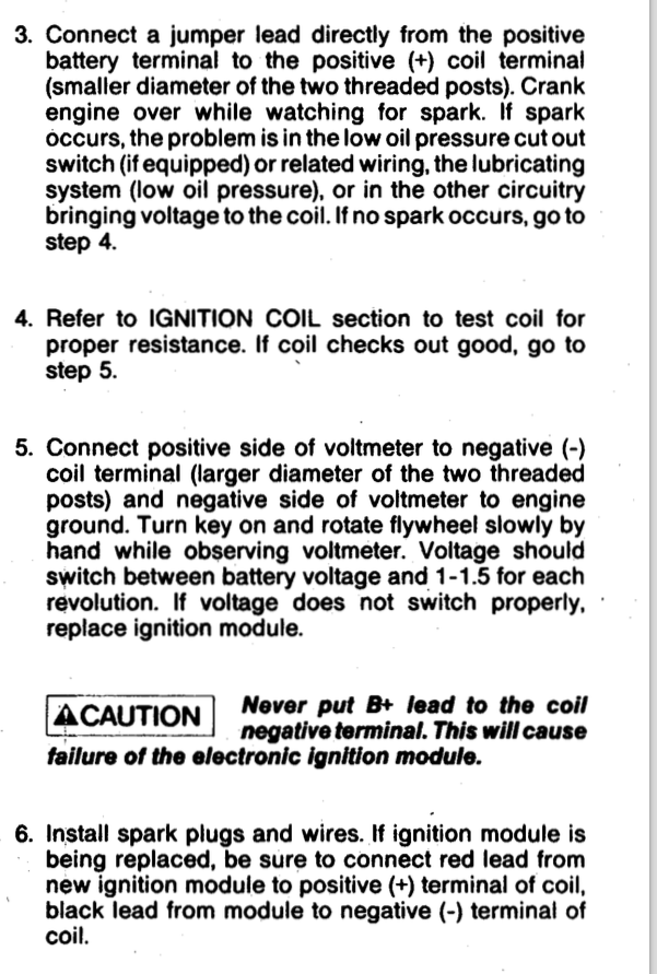

gwest_ca-(File Mod) 12,325 #2 Posted August 8, 2015 (edited) I don't know anything about this ignition system but the spark plugs fire each time the power to the ignition coil primary winding is interrupted. With a system using points and condenser this happens when the points open. With the electronic ignition this is done by the trigger module. I will guess you are getting the one spark because you shut the ignition off and that interrupted the power to the coil primary one time. I believe some Onans have a condenser on the coil (+) side of the coil primary. I don't know what happens if it fails.The procedure for checking the ignition is in the Onan service manualhttp://www.wheelhorseforum.com/files/file/6-engine-onan-p216-p218-p220-p240-sm-492-4006pdf/Garry Edited August 8, 2015 by gwest_ca Share this post Link to post Share on other sites

Skreegy 0 #13 Posted August 15, 2015 (edited) Hello All,Just hoping someone can check my reasoning out please :-Current status of problem. I have - Fitted new ignition switch Checked all connections -made good a few faulty ones and cleaned and continuity checked all of them Have correct voltage to coil both on 'run' and 'crank'. coil primary and secondary windings both within correct parameters followed steps for checking ignition module by using voltmeter across negative coil terminal and earth. I think this is the issue as I never show 12 volts at any flywheel position (reads 0.970 v) and there is no fluctuation of voltage as I turn the flywheel. I still get no spark at plugs, except when turning key from run to off, then I get a single spark at each plug. My thinking is that I have a faulty ignition module, although I am concerned that I never get 12 volts at any position.Your views would be very welcomed. Please accept my apologies for this 'dragging' on.Thanks for reading,Matt. Edited August 15, 2015 by Skreegy more inormation Share this post Link to post Share on other sites

WNYPCRepair 1,924 #15 Posted August 15, 2015 Have you checked for a corroded ground? That would result in lower voltage, as the corrosion will act as a resistor Share this post Link to post Share on other sites
cheesegrader 436 #16 Posted August 23, 2015 I'm far from expert on electrical issues, but I am being forced to learn the hard way.I thought the voltage should change by 1.5 volts each time the flywheel comes around, and that failure to read this indicates a bad ignition module.Expensive little beasts at about $75 dollars. I couldn't get my flywheel off, and had to get help. Share this post Link to post Share on other sites
Skreegy 0 #17 Posted August 23, 2015 Hello, and thanks for the comments.Checked the earth's, cleaned etc. no change to the readings across the 'flywheel'. I am of the opinion that it is the trigger module. Removing the flywheel has beaten me at the moment, so 'Mr tractor' is laying 'in state' in the work shed. Luckily it's getting close to 'grass not growing' for a few months! Share this post Link to post Share on other sites
WNYPCRepair 1,924 #18 Posted August 23, 2015 (edited) Hello, and thanks for the comments.Checked the earth's, cleaned etc. no change to the readings across the 'flywheel'. I am of the opinion that it is the trigger module. Removing the flywheel has beaten me at the moment, so 'Mr tractor' is laying 'in state' in the work shed. Luckily it's getting close to 'grass not growing' for a few months! If you have ruled out the low oil pressure switch, etc., then I would think it is the ignition module, according to the manual. I just wonder why you aren't getting 12v Edited August 23, 2015 by WNYPCRepair Share this post Link to post Share on other sites
