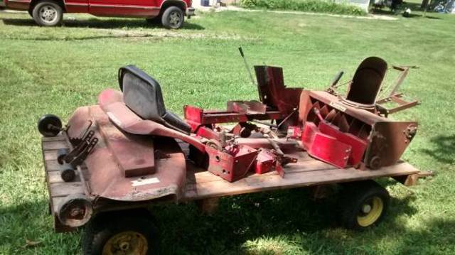

I found a snow blower the guy says he had it on a charger 12 it looks like a single stage short shoot blower will it fit on a c series if it was on a charger 12? Sent from my XT1080 using Tapatalk

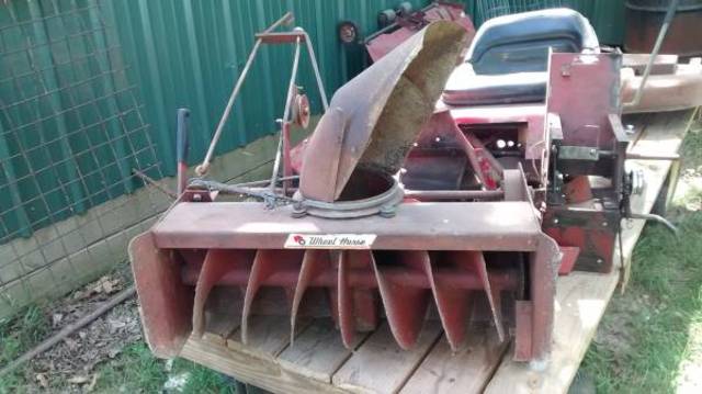

these are the pics i have of it

That is a pre attachamatic model. The mounting point consists of a long bolt that goes thru the front of the frame on the tractor. It CAN be converted to fit and work on a c series.

would it still use a lift flag?
oldredrider
Yes, it uses the flag and lift tube. The only difference is the mounting and belt length.
